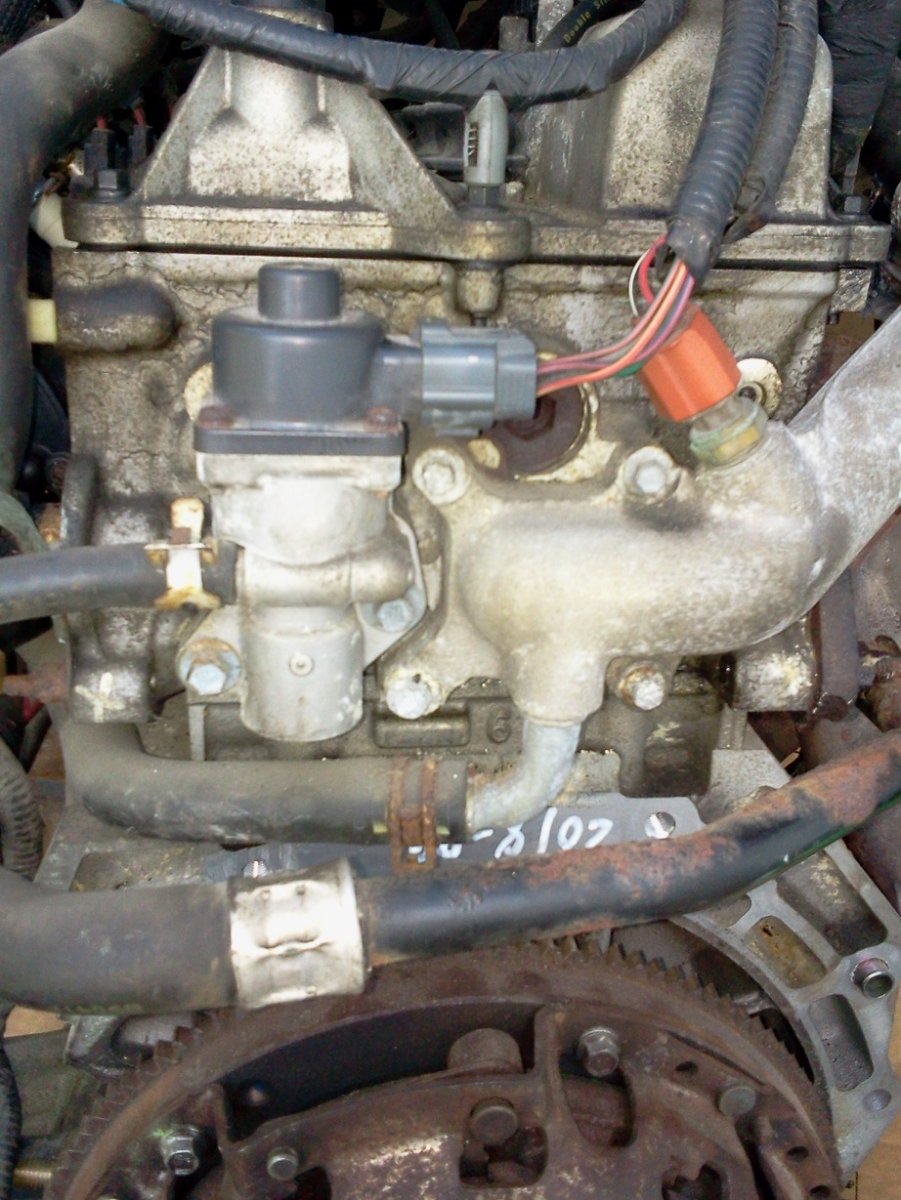

there isn't much to the head temp sensor circuit.
starts at pin 66 of the pcm, goes to the sensor, then to a common signal ground which goes back to pin 91 on the pcm.
the engine coolant temp sensor is on the big metal tube at the rear of the engine, the one you can't see or reach.
it's the orange one in this pi
c.
