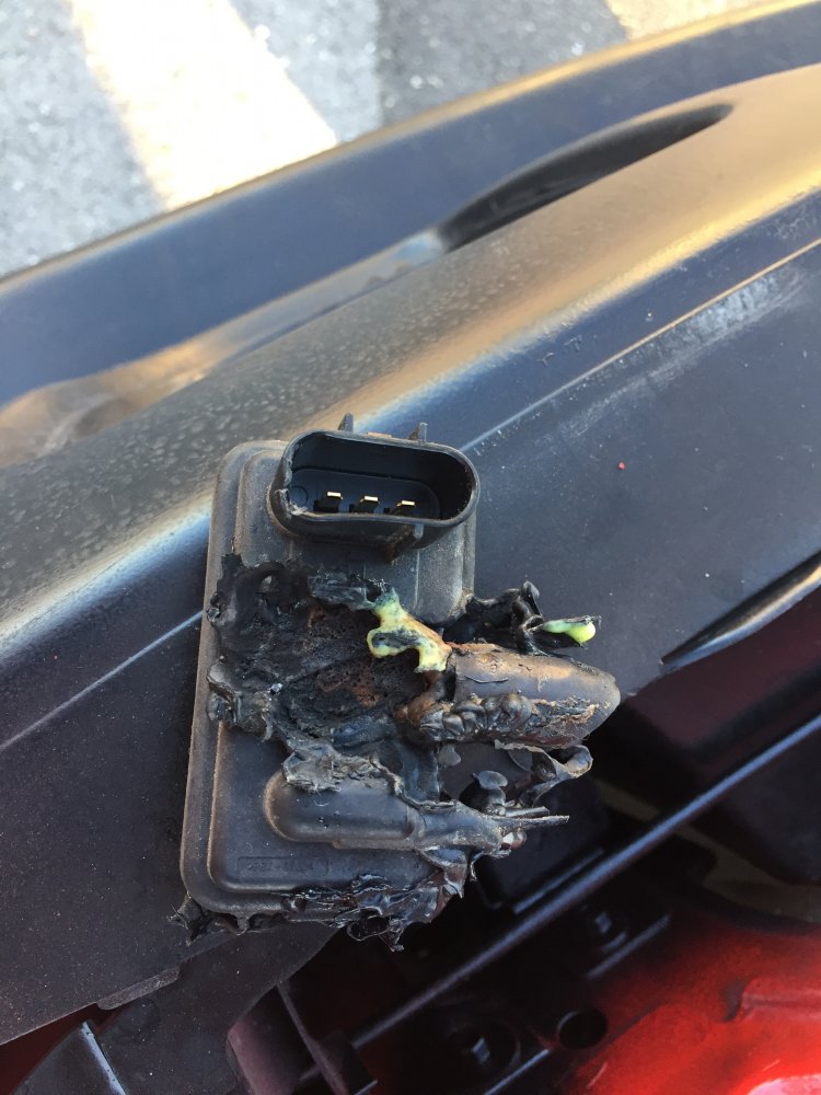

This thing by oil dip stick melted. CodeP104

I will take picture of melted thing to ad to here.

Well, obviously, as you know, it will run without that. The DPFE sensor controls the EGR valve and all that has to do with emissions. Someone else will give more detail about how well or poorly the engine will run this way. But its going to “throw a code” until you replace the sensor Which is pretty easy and not extremely expensive.

Guess what that sensor does? It measures the pressure in the exhaust gas pipe that leads to the EGR. When there is a higher pressure in the pipe, that means the EGR is closed. When the pressure drops, that means the EGR valve is open.
Where does this pressure in this pipe come from? Back pressure in the exhaust system.
What happens when you open the exhaust up for more power and less exhaust back pressure? There is less pressure in this pipe. The sensor thinks the EGR is open all the time, and it sends a code and you end up in the same situation you are in now. That is why only cat-back exhaust is legal. The complete front part of the exhaust and all the cat's are considered emissions devices and the engine and the sensors are calibrated for it.

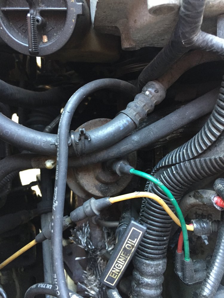

I see the ERG valve has some kind of big fitting on it that looks hard to loosen.

There is nothing wrong with the EGR valve itself is it? You are right, they can be difficult to get off sometimes. If your idle is smooth, and when you connect straight manifold vacuum to the EGR the engine stalls out, then the valve itself is ok.
I am away from and don’t have tools to remove, will try to. Get control sensor regulator thing and see what happens. Idles and reeves fine under no load.
