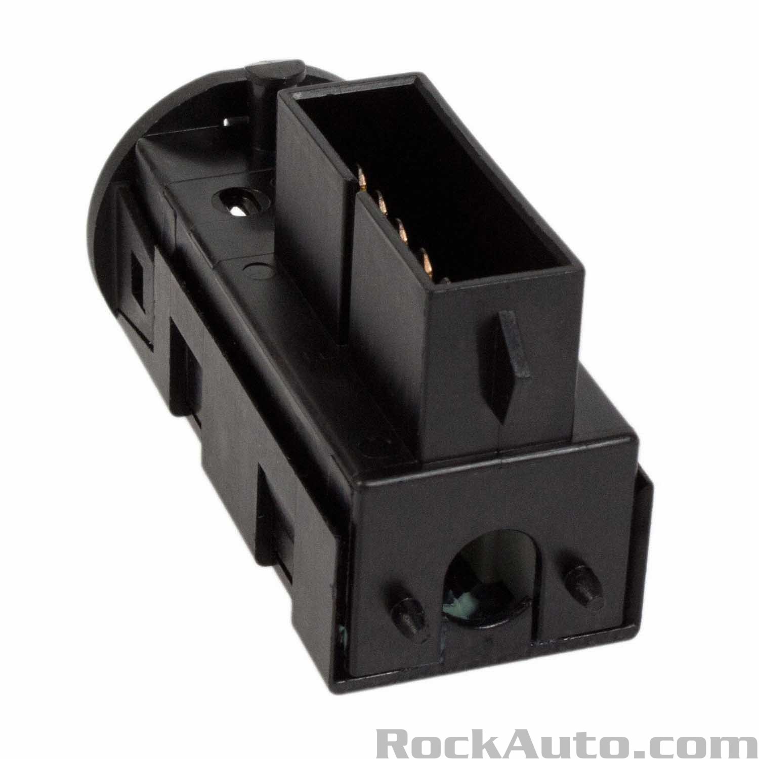

So, how does that clutch interlock feature work? I noticed there is a module that free floats on the pedal rod. Thanks.
IDK about the stiff pedal, but you did describe the clutch safety switch. It looks like this:
My switch module floats freely on the rod. There is supposed to be an orientation clip on the end of the clutch master that clips into the switch that is not there. Looks like maybe it never had one. Thats why I think this clutch master is for another vehicle.
That switch started in '88, earlier ones were not floating on the rod like that.
