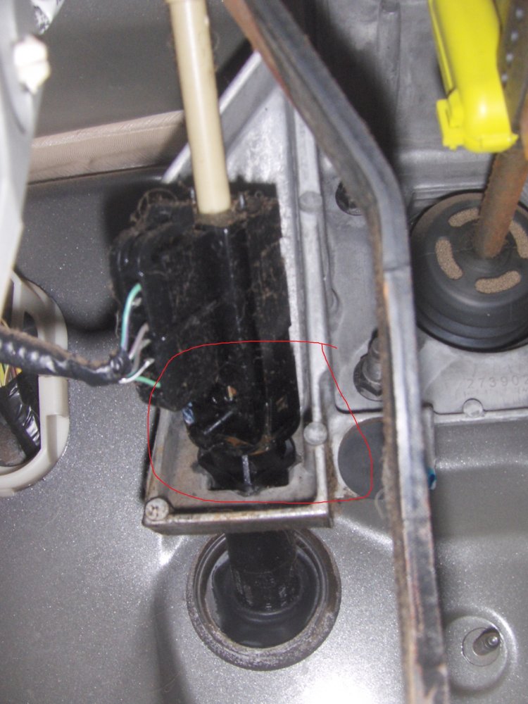

A little about the truck...08, 110,000 miles. It's getting harder to get it into 1st gear when I get ready to take off. Once I get going and shifting, it's fine. If I'm at a stand still, I goes into reverse with no problems. I initially thought that the clutch hydraulic system might need to be bled, so I was getting ready to give it a try when I discovered something about the rod assembly for the master cylinder. It looks wet near inside the cab, just before it goes to the firewall. It looks like moist, like something has been leaking. It's ever so slightly wet, but doesn't seem right. I attached a pic and circled the area I'm talking about. Does it appear to be leaking, or is it normal?

Its probably beginning to leak. Is the fluid level dropping?
It could be starting to leak... but I would think it would be wet around the boot coming through the firewall.

No leaking visible near the master cylinder boot at the firewall. I'm getting ready to raise it and have a look underneath at the line and the slave cylinder.
