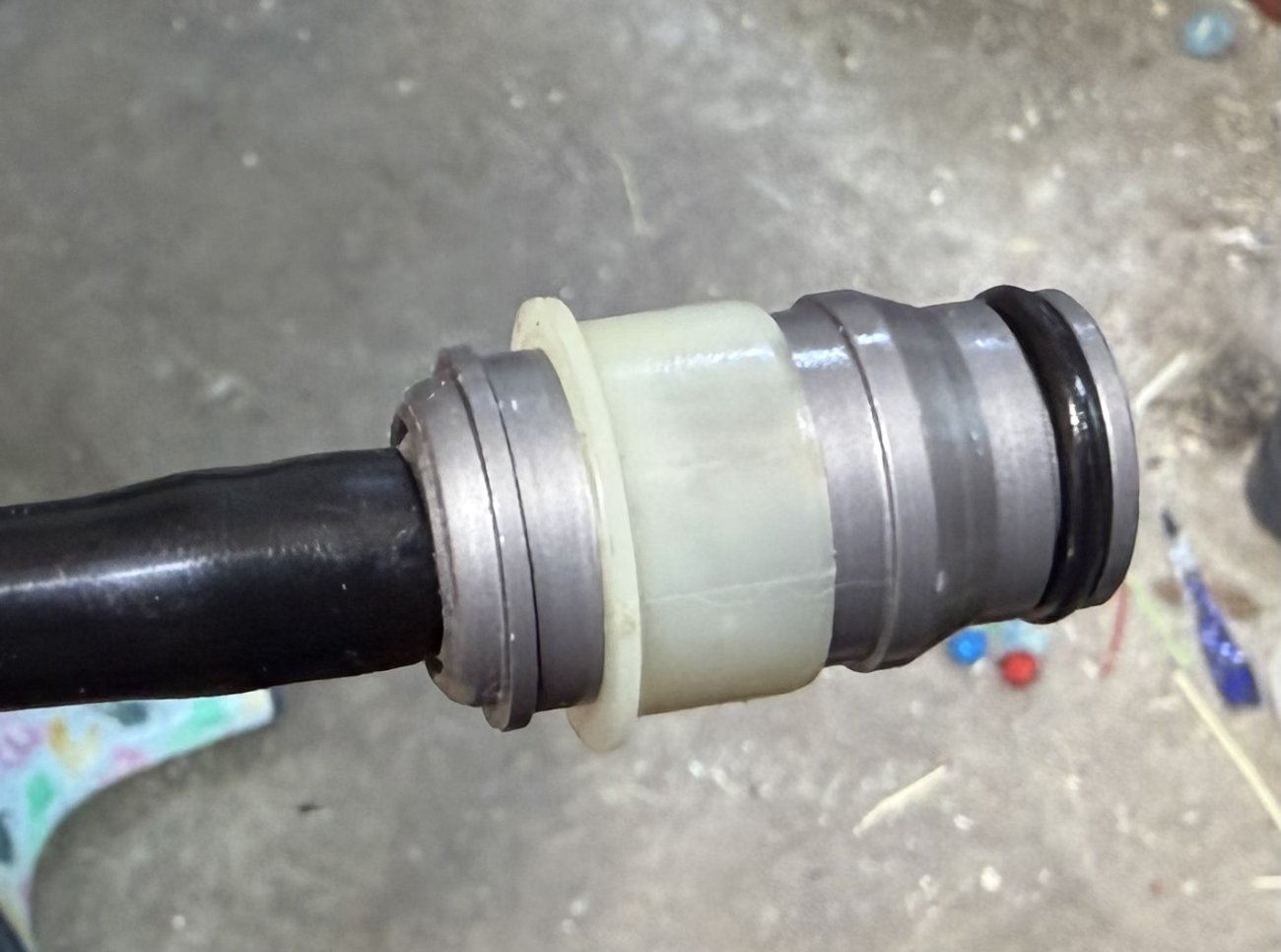

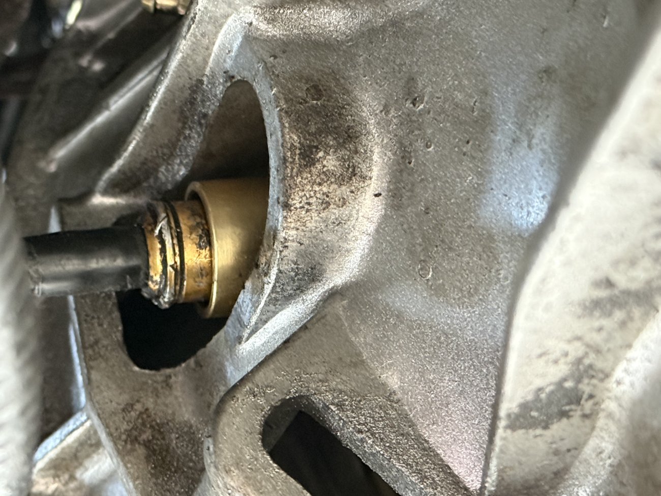

I am trying to replace the master cylinder for my clutch and the "white plastic ring" that you're supposed to push in on is not there. I think this is the original line and the truck is 28 years old, so I guess I am not surprised. I just had the slave cylinder replaced. The last slave cylinder used a c-clip retainer but the new one does not.
I am trying to figure out how to disconnect the line without the white plastic ring now. From measuring the one on the new line, it appears to be about the same thickness as a milk jug so I am thinking about cutting a piece of jug and trying to use it to push in and disconnect the coupler. A fuel line tool is too thick. Have any of you run into this before? I'm hoping there is someone smarter than me on this one. Photos of the installed coupler and the new one with the white plastic piece are attached.

In your picture, you see the white plastic ring, then a narrow portion of the gray piece and then a shoulder. There is an o-ring seal in that narrow area. Pushing the white piece in wedges it under the o-ring and expands it so that the shoulder of the gray piece can slide out. The o-ring is also trapped in a groove in the housing of the coupler.

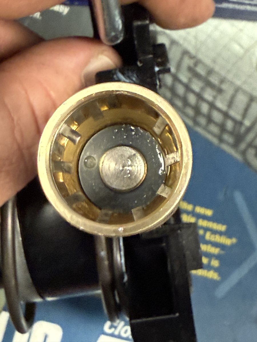

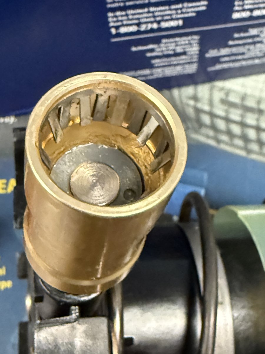

That does help, thanks. Here are some pictures of the inside of a new coupling that I took at my friendly local NAPA this morning.
Oof, might need something thicker, maybe try a layer of electrical tape on the inside of the milk jug or something to thicken it up gradually, also you will likely have to push in a little on the clutch line to help the tangs disengage from the aluminum...
