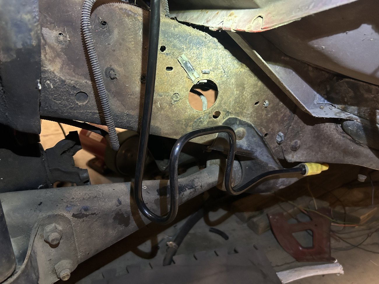

I've swapped manual transmissions from a FM145/146 to a M5OD. Now I need to hook up the NEW hydraulic line and bleed it.

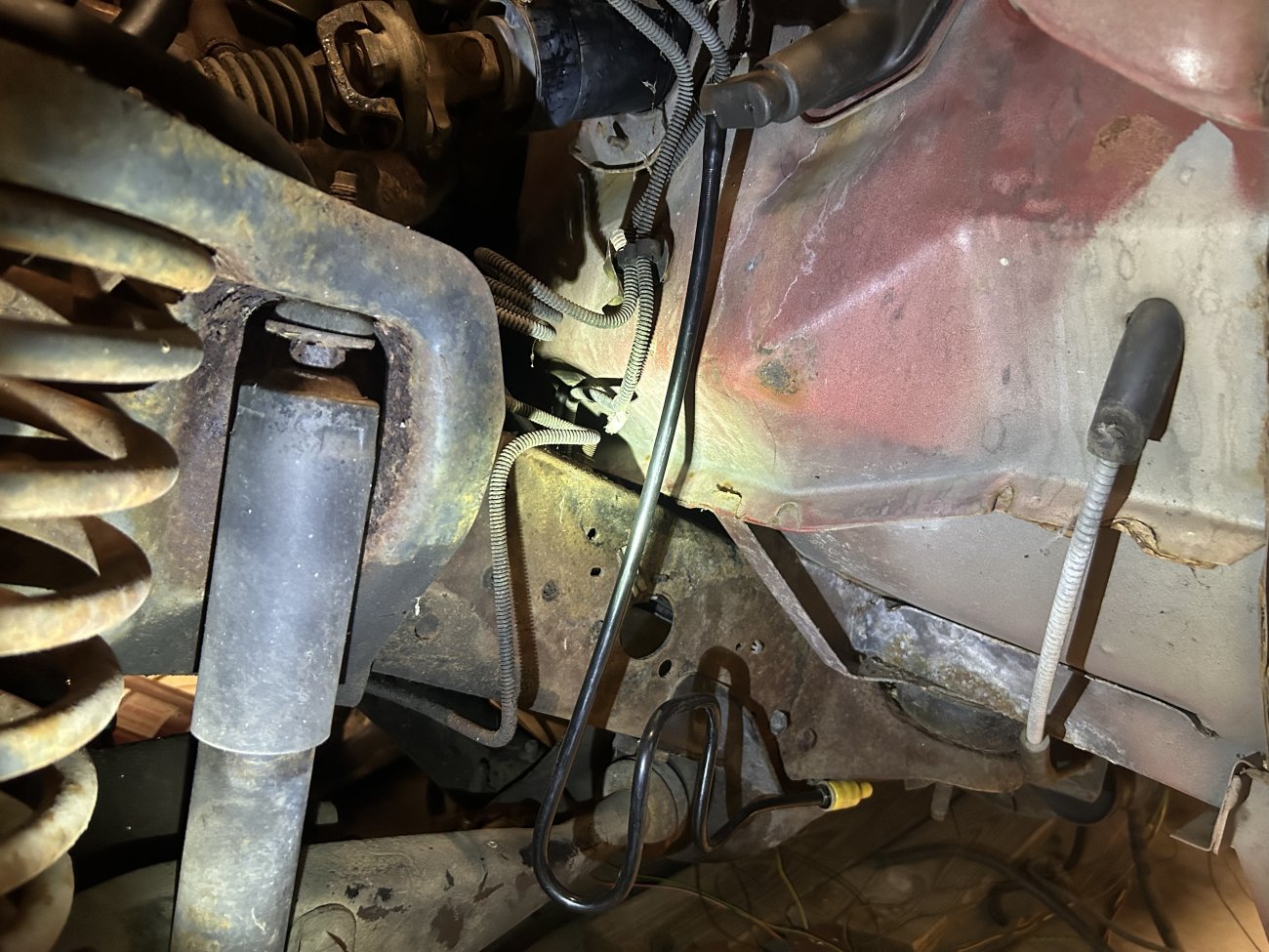

Another Pic:
I need to get the line over the frame rail, can I heat it with a heat gun and bend the plastic to have it fit better. I dont want to kink it. Does anyone have a pic of what they've done...?
Thanks,
Why is is so much different on your truck? What did that line come from? I would think most rangers are generally setup the same way.
That looks like the lines that's on my truck. I had it disconnected from the master already so just pushed it up from inside the frame rail and had a helper grab it and hold it up while I crawled out from under the truck. Then back under to plug in the quick disconnect.
