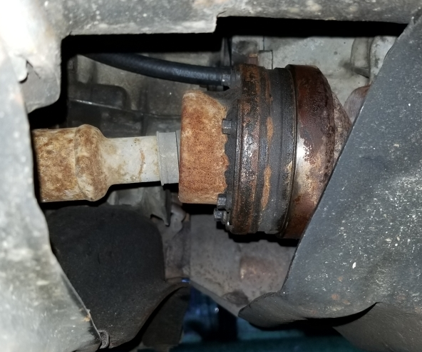

I put the new leaf springs, shackles and u-bots on. Took me several days. The ride does feel stiffer and seems to have minimized some vibrations that were occurring at highway speeds. However, the clunking while in 4wd is still occurring when going up hills. So now I'm looking at u joints and drive shaft angles. The picture below is the front drive shaft connecting to the transfer case. Does that angle seem to much? I did not get a chance to measure, What is the proper angle coming out of the transfer case to the front drive shaft. Also, there is no lift on the truck, should be pretty much stock. Could bad engine and transmission mounts cause these angles to be off?
Those CV type joints are probably part of your problem, those things are horrible when they fail, all sorts of noise, my 88 Bronco 2 had those when I got it, when I had the transmission rebuilt I had them send the drivelines to a shop and have them rebuilt with U-Joints. Expensive but worth it to get rid of that CV joint garbage.
I have had both the cv joints replaced in the last 2 years, didn't seem to make a difference. So I don't know where the clunking seems to be coming from, but I decided to just let it be and if something eventually breaks, I can fix it. Until then, I will just keep wheeling.
