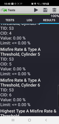

Here's an image taken from your video showing cylinders 4, 5, and 6:
I noticed that the "Limit:" values for all 6 cylinders is zero. This is not normal. I suspect that it means that the misfire monitor is not actually running.
I'm guessing that at some point, you've disconnected the battery cable, wiping out the KAM (Keep-Alive Memory) in the PCM. This would mean that the misfire monitors won't run until the "correction factor" for the "Profile Correction" software in the PCM is re-learned, by doing one or more 60-to-40-mph, no-throttle, no-brake decelerations. IMHO, until you can do that, the misfire data should be treated with suspicion, unfortunately.
P.S. That video also shows that 3 (all?) of your O2 sensors have a problem with the heater element current being below minimum, so after you solve the engine issue, that might be worth a further look.
