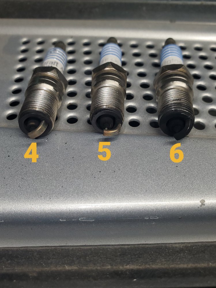

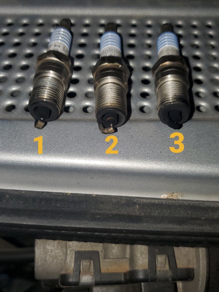

Compression test done. I'm glad they are all good and within percentage. Plug #3 and #6 are black. These plugs were new and are autolite platinum fine wires

Engine is for sure running Rich by the look of those spark plug tips, or oil vapor is getting in
3 and 6 especially, but all are blackish

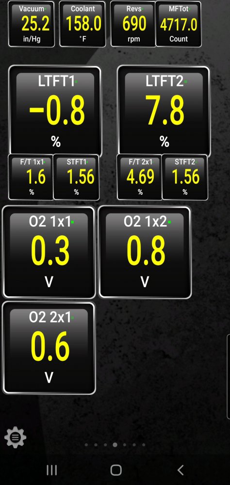

The total # of misfires is the top right corner reading.... where it says MFTOT.....VideoCapture_20211022-191130.jpg
The only other thing mechanical that could cause it would be if and exhaust valve isn't opening. It certainly has a misfire according to your counts.
