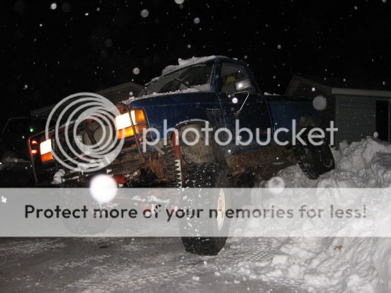

Found some pics in a photo album.....
Man that thing looks good on 36's :thumb:

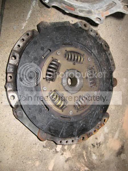

Well on the way to the Sundowner BB/BS ride something in my clutch decided to let go. Well i finally got it a part and found that the throw out bearing locked up and over heated the slave cylinder.
The clutch didn't like rocks and 36's with 3.73s.
