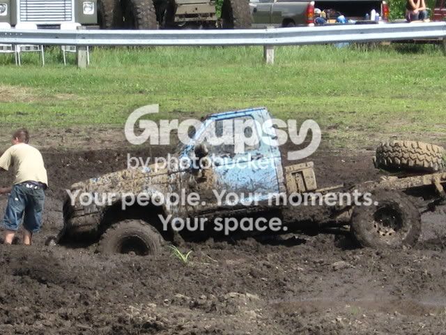

The drivers rear tire is off the ground.
Chester Replacement
A couple of weeks ago well running at Bear Swamp is got stuck and when the tractor pulled me out the passager front tire was in a hole. It ending up bending the radius arm.
