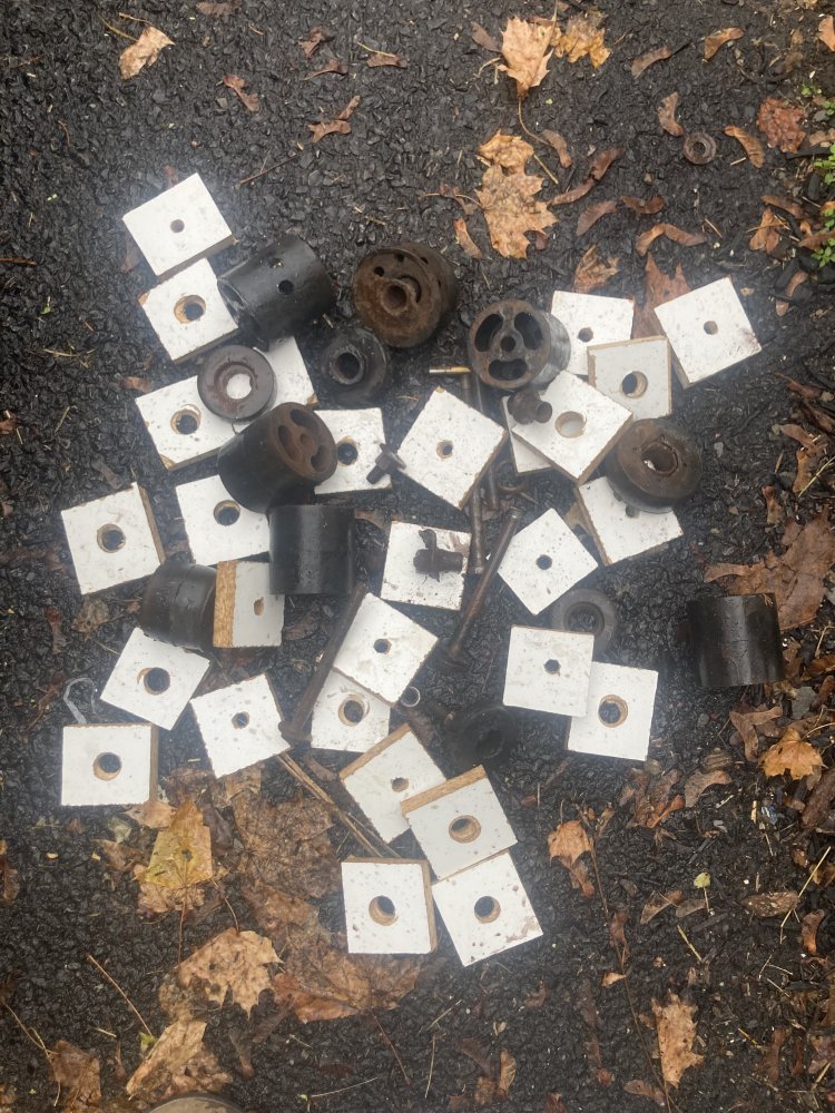

Lowered the cab!
Here's some of the old bits, as well as the shim system i made out of 3/4" melamine so that after getting the old 3" lifts out i could go around and sub stacks of these in place and then lower the cab incrementally decreasing the stacks at each spot. Worked great!

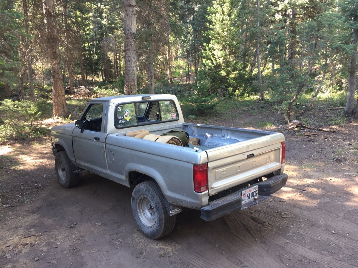

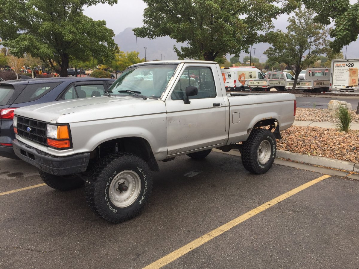

here are pics of with the 3" body lift, with no body lift and the 4" suspension lift and then with the suspension lift and new 31" tires
Looks great!! Did you install the suspension lift yourself?
