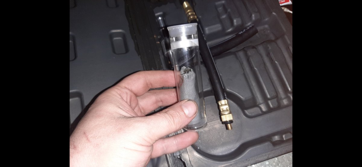

Are you talking about the "Tankweld" type? I have a couple packages of the "steelstik" kind that I bought to fix something... and Kwik Weld, I have that too. The tankweld one looks like it might be my best bet.
I lost the packaging but it comes in a tube like this... I THINK its tank weld.
