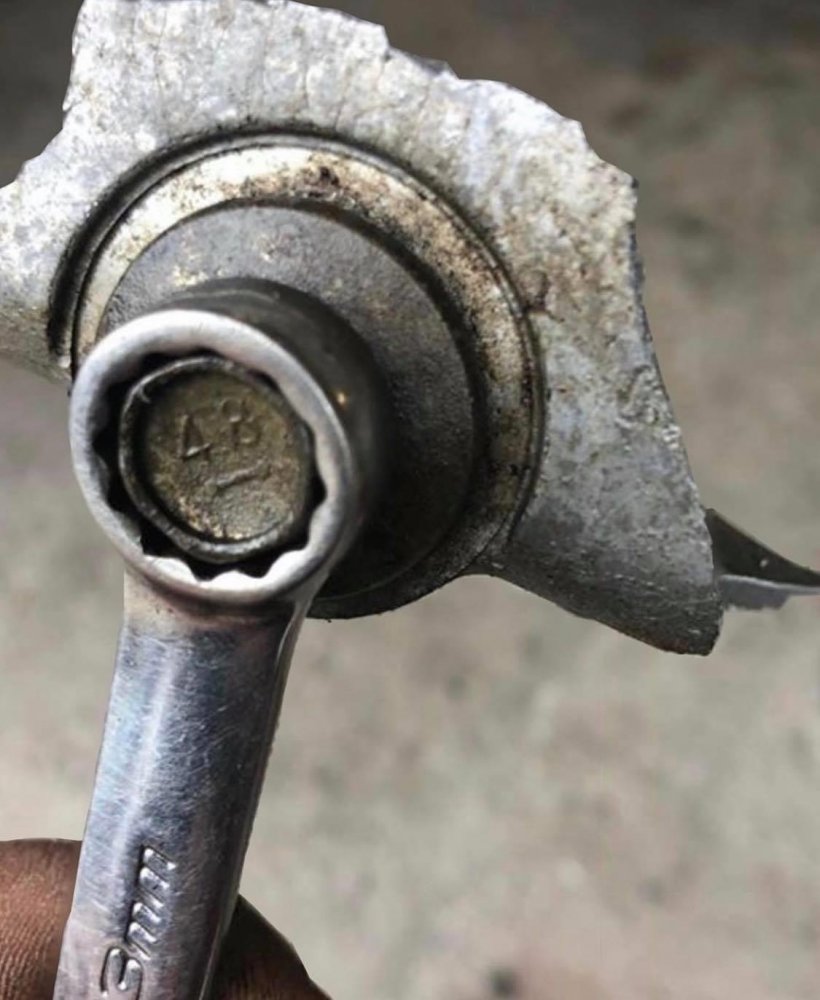

This pic reminded me of this thread.
43382
If the crack expands/contracts when the plug is inserted/removed, you could stuff JB Weld into the crack, and then remove the plug. The contraction would tend to hold the fix in place. Once set, I would re-drill & tap the hole to the proper size.
Don't forget to drill the end of the crack so it has a 'stopping' point.

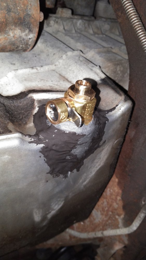

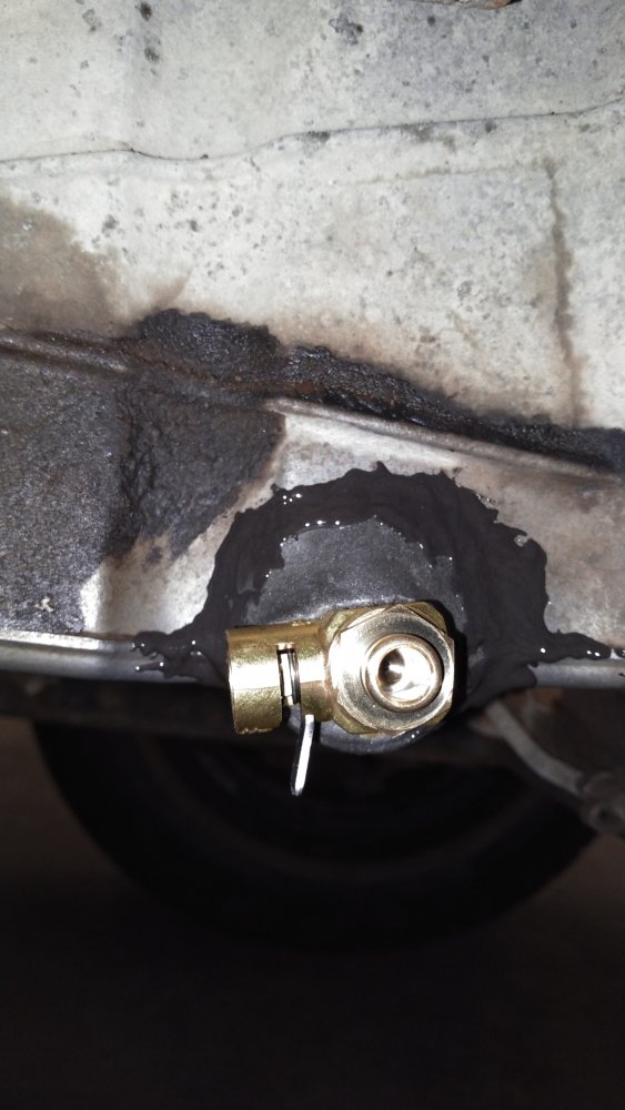

Here's what I did... I'm filling it with oil tonight after a 24 hour cure time, fingers crossed it holds. I ordered a Fumoto drain valve and let the oil drain for two weeks while I was on vacation. I then jacked up the passenger side of the truck so that any remaining oil would drain towards the driver's side of the pan, and cleaned everything with a wire brush and copious amounts of brake cleaner. I then used JB Quick Weld on the threads and the flange to glue the drain valve in place, then used Steel Stik putty on the bottom where the crack is and again around the top of the valve. After that cured I spread more Quick Weld around the edges of the putty.

I think it'll hold fine. I'd buy the lil lock for the valve. I've heard stories of them getting knocked open when the valve lever hangs down like that one does. The locks are cheap insurance.
It came with the lock as well as a rubber cap for the nozzle, just didn't have it installed for the pic. I was hoping to have the lever at the 12:00 position but it was awful tight right there and I didn't feel like pushing my luck. Probably would have pulled whatever threads are left out if I went much further.
My fingers are crossed for you, if I did that it would bite me in the arse.
I let it idle in my driveway for an hour on Tuesday and so far so good, no leak.
