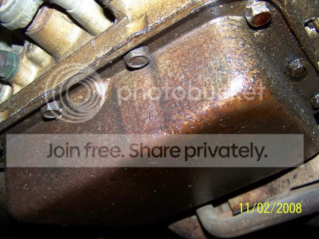

ok well it doesnt have the "hump" like the picture. but my pan bolts are like the c4-c5 and all the other pan bolts have way more....
what the hell?
The C3 has 13 bolts on the pan, while the C4 & C5 have 11 bolts on the pan, there are tons of C4's & C5's without the hump on the pan, the trans could have swapped out with a reman/rebuilt tranny hence the no "hump", just because it doesn't have hump doesn't mean it isn't a C4/C5.

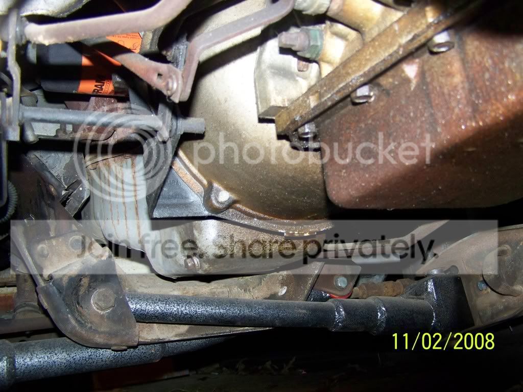

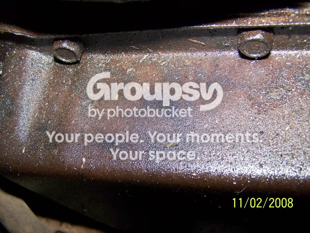

well it deffinatly has 11 bolts. 3 on 3 sides and 2 in the front, heres a few pics. sry they arent great

Looking at the pics you took of the pan it's alot deeper looking than a C3 pan. Another check to see if the trans is a C4/C5 is to look right behind the shifter arm on the side of the trans there should be stamped steel cover with 4 bolts holding it on, the is also another cover on the other side right behind the bellhousing that is cast aluminum and is also held on by 4 bolts, if it has those 2 covers with 4 bolts on each one it's a C4/C5 trans.
hmm ok, well ill go check that tomorrow then, its gettin to cold outside! concrete is freezing! lol
