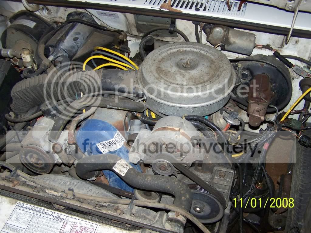

i just noticed though, shouldnt your truck be a 2.0...and shouldnt it be carbed?
hahah THATS WHAT WAS THINKIN when i bought it. i originally wanted it for parts, i have a 91 ext. cab, but the old lady said o it runs, and has 29,000 miles on it! so i gave her $1,000 and drove it home. but i checked the VIN and its "A" and it is carbed
look, i just took these for ya
sticker on core support
carbed, just real dirty
