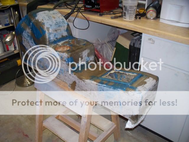

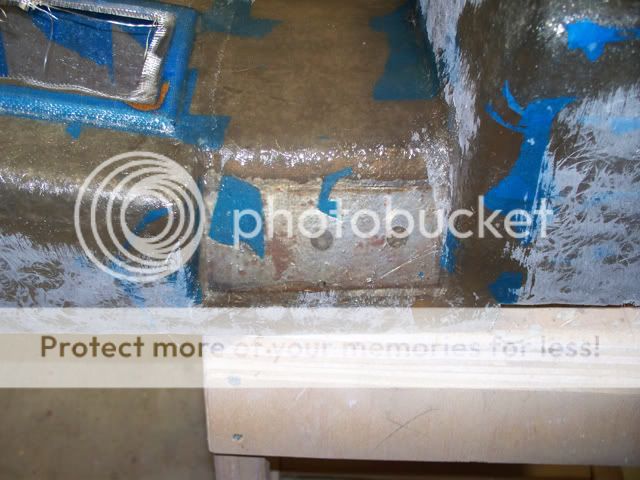

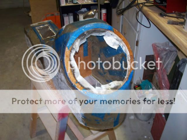

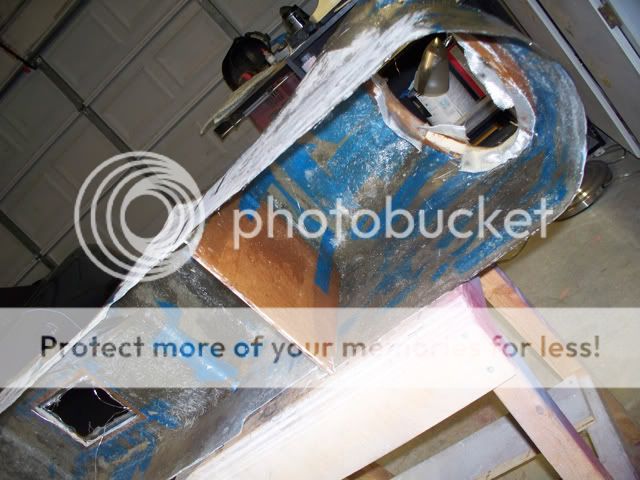

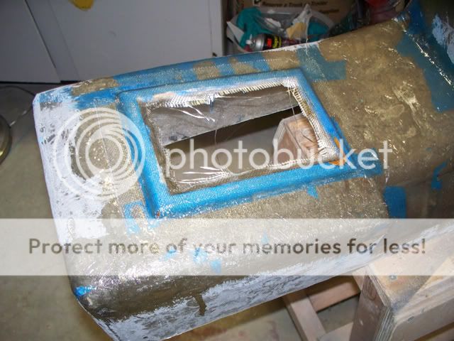

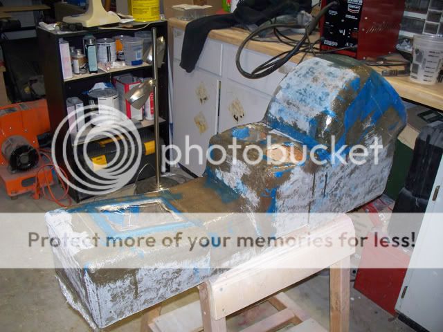

OK today I trimmed the lower edges, the shifter opening, the speaker opening and the cup holders holes. Then I began adding some more layers of glass in certain areas to add strength and thickness inside the sub area. You can also see where I added the baffle for the sub and the switch mounting plate.

I have more work to do before I begin laying in the filler on the exterior. But I will try to shoot more pics as I make progress.
It is covered on the sub side with fiberglass, so that adds additional strength to it. Besides I won't be entering any sound offs - LOL.
I used a 1/4 inch thick board on the back of my box, and when there is a decent amount of bass the board vibrates real loud.
Just curious - is your fiberglassed or only MDF? I just used the board to lay up the fiberglass, see my next post for additional pictures. I am pretty sure there will be no movement of the board - I could be wrong - but I have enough layers of fiberglass on the inside that the boards are no longer necessary.

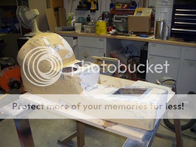

Getting closer - I got a lot done in the last couple days so without ado here are some pics with descriptions
Filler
Center Console Build

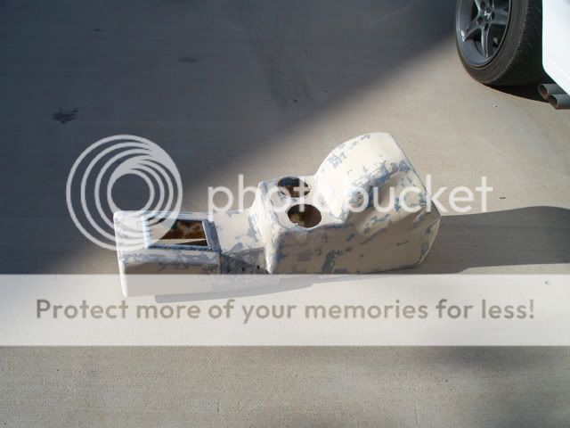

First 2 layers sanded down - one more to go for the filler . . .

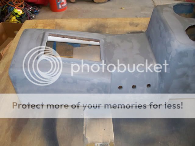

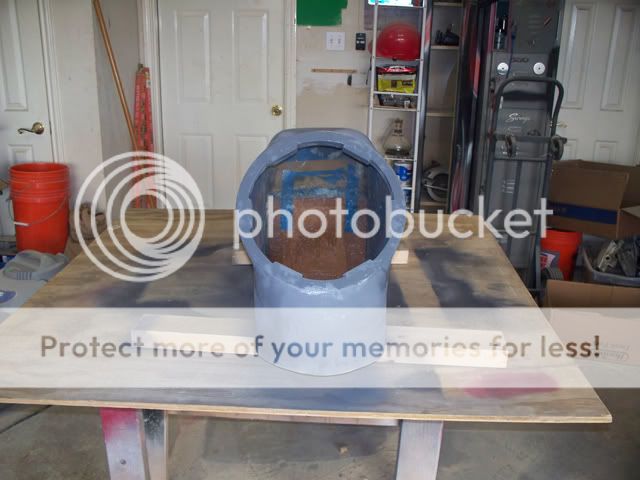

Primered - just for appearance and to check overall finish - :shok: needs mre sanding and finish putty or a milkshake to get it all smoothed out

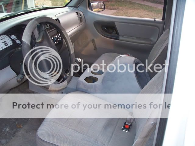

Test fit in the truck - yes it is supposed to be that far forward - I will have to be careful when tilting the seats forward or no tilting.

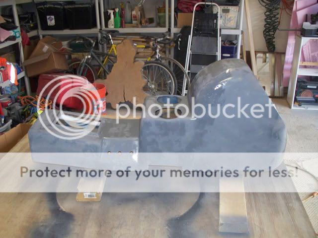

No pics for this update, but tonight I laid on a milkshake coat (resin and filler mix) and sanded that down. Then I put on a thin thin layer of glazing putty to fill scratches and pin holes. I am hoping to have that sanded to 220 or 320 tomorrow night and then another couple coats of primer. If all of that comes out good I will have it painted this weekend.
Not yet, I am still trying to decide on what color and if I will incorporate any design features like stripes or something. Plus I am out of town most of this week and then next week I leave for 2 weeks.
