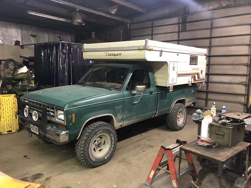

I just don't know if I have enough room:
In your case i would do mag mount, I realize the camper shell is aluminum but you could make a bracket for it out of steel on the shell. Then when the camper is off, the mag mount can go on the cab.
