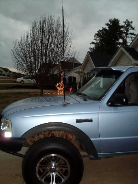

Thanks for all the replies. What would you all put on your truck that is a DD a 102 Whip or a shorter fiberglass antenna? And where would you all mount both of these antennas?
i have me a 102" whip on my DD i wont have anything else, i first had it on my back bumper but i was hitting trees while i was doing some side jobs in rich neighborhoods but eventually i got it on my toolbox and about the only thing i hit is low overhead stuff

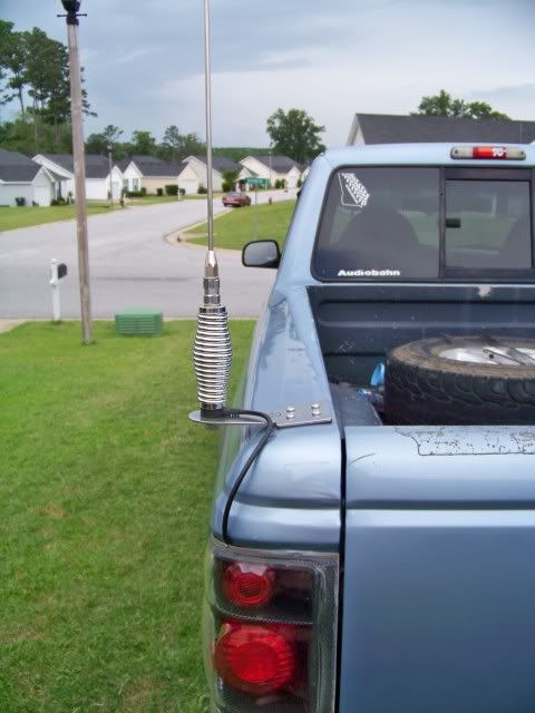

A bud of mine uses a 102" whip w/ a 6" spring on a ball mount, he uses the ball mount as a swivel to bend the whip down to go in garages

Back to the subject of the 102 incher. Go to your local radio shack and get a mount for your toolbox if you have one, if not they make a mount to go in the corner of your truck bed. Get the mount and a ball and base combo. It comes in one big pack. Then get a big spring. Not the little 1" diameter springs. The big ones that are medium size at the top and the bottom and fat in the middle. Then get the 102" whip.
Now when you mount it make sure the center/hot pin on the base doesnt touch the mount in the middle of the mount. Then bolt your base down using the instructions. Now the only thing most people wont tell you but I find very important is do this: take a piece of wire about 12ga and two terminal ends. The yellow ones with a large hole. Make a piece of wire about 6"s long and crimp the terminal on both ends. now when you put the spring on, before you screw it into the ball, place the wire between base and spring on the stud. The put the other end between the spring and antenna when you screw it on. This way when the spring is bending a lot if the wire inside the spring breaks, you still have signal.
