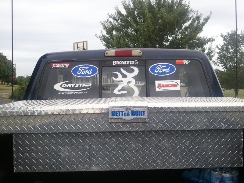

Yea I had a 102 inch whip before. It looked pretty good but I've always liked the way antennas look when mounted on a toolbox. And needless to say, its hard to match a steel whip, so gotta go with 2 little ones lol.
I hear ya but i dont know wht im goin to do. I might mock up different places and see what i like best.
don't do dual antennas... our trucks are not big enough for them, each antenna will cause interference with the opposite one...
if you've ever noticed, semi trucks with dual antennas have them mounted on the outside of the mirrors, because that's about the minimum distance needed to not have major interference...
the only way to do it on our trucks without major issues is to put one on the front, and one on the back, preferably opposite corners
dual antennas are just useless usually...
like weezl said, they interfere w/ each other. i work part time at a semi body shop; more and more truckers are getting away from dual antennas and just using one GOOD antenna.
its just so much simpler. and a lot of us are just using the cb for a trail radio anyways-- you don't need that much stuff for it.

I peraonally havent noticed any interference running 2 antennas. Mainly though I just.like the style of it. Plus my radio is putting out pr.etty good so why not have 2
