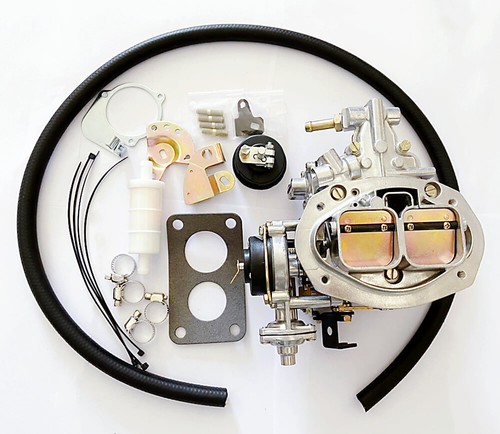

I bought a non Weber branded 32/36 off of Ebay. I'll share you the link, it comes in a kit and I'd say for the price was worth it. Hopefully it's not a piece of shit and was a waste of money. Does make me a little nervous putting one on I've been told from other people that they're pretty much plug in and play for 2.3Ls, especially jetting size. Also talked to some MGB guys since their motors are a little smaller than ours and they run twin 32/36s.
Here's the carburetor I bought.
That looks like a good price and the progressive part should work good. Be prepared to work with it a little bit since it's a knock-off. My 2100 knock-off had a few little problems that I had to address. Like the top bowl gasket wasn't cut exactly right and seeped fuel. The power valve didn't act right and the accelerator pump got changed, I forgot why now. But those good used parts came from the old feedback carb I took off. It's been running good since. It's just like stuff from Harbor Freight; They give you something to work with, and a little tweak here and there and it can be good.
knock of webers are usually bad so i hope you have zero trouble.
