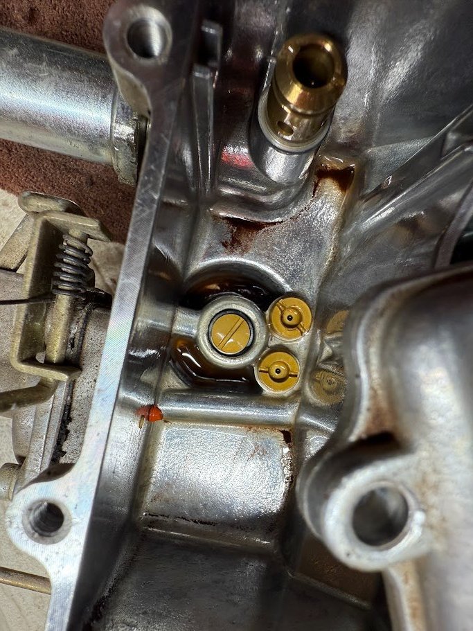

Just for fun I pulled the top off the China carb, this is how much rust got caught in the float bowl in about 50 miles... the indentation in the bottom where the power valve sits is packed full.

The accelerator pump cavity i believe is the lowest spot in that carb. It's probably full of crude too.

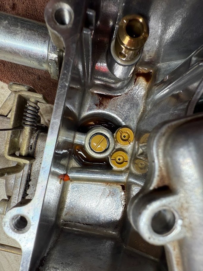

The stock type fuel filter screwed into the carb is basically just a screen and is apt to be full of rust. When you clean out the carb make sure to replace it so you don't contaminate the carb again. If you have an inline filter you don't really need the stock one but it makes a good nipple for a hose connection.
