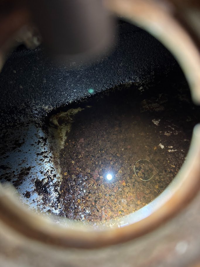

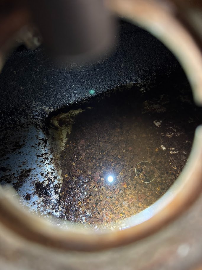

Found the problem... this was "cleaned out..." right. I never witnessed these kids eating tide pods or anything but I'm starting to suspect it.
New tank is in, I sucked about 4 gallons of gas out of the old tank. I'm not putting it back in, gonna run it in the lawnmower or something.

That looks pretty good compared to my Bronco II tank I replaced.

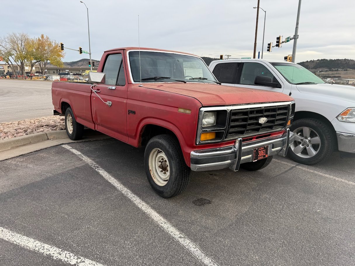

Nice looking old school truck
It's very solid as far as bull nose Fords go. Just a couple small rust spots in the cab corners and by the rear bumper.
I REALLY wish the previous owner had just left the paint alone. It was gold with brown interior and now it's spray painted red with spray painted black interior. No surprise it's all flaking off.
