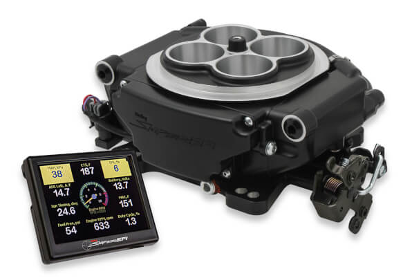

What about using the fuel injection "carburetors" they offer for you to swap over to fi in older trucks. With the carborated manifold and the fi "carb" you get the simple clean look and install with the benefit of fi and fuel monitoring
You mean this?
Holley's "sniper" EFI?
I have zero experence with it.
Im not an EFI fan, i think a carb would do just fine on a 2.9 as long as you properly size it. Why dont you post over on the 2.8 board and/or do some googleing to see what guys are running for performance on those then that'll give you an idea of the right carb size for a 2.9.
My gut just tells me a 600 would be way to much for a 2.9. With the secondaries disabled youre basically running a 2bbl and you might as well save yourself some money, get a 2bbl adaptor and just run a 2150 motorcraft that even in its largest iteration (on 351M/400s) pulled 335CFM.

You mean this?

Secondaries would not be disabled. A vacuum secondary carb is sort of a "self sizing" carb, it only gives the engine what it needs or can use, if the engine doesn't need or can't use the secondaries, they will not open up. Of course this is all adjustable with different springs and such.
I am contemplating this, #1 because the 390cfm carb is so expensive compared to the 600cfm, which I happen to have several of already. That and the fact that when discussing the 2.8 carbs, that some people are having success with the larger 2150's made for v8's on their engines. I am thinking if anything is going to be too large or off, it's going to be the idle air bleeds and stuff like that which is a little bit difficult to change out and modify.
I would love to try one of those aftermarket fuel injection systems. I am sure they would work, they even have them that run the factory 8 injectors for LS conversions and such. There must be a way to make one of those run a v6 engine with 6 injectors, so no need to modify the intake at all, just keep the 6 injector system. What would you have with this? A tuneable injection system that you can actually troubleshoot and communicate with unlike the EECIV. What's the problem with this? The money problem rares it's head up again.
If I go the MSD route, I am going to have to save up for a little while, that unit being close to $400 refurbished is still a lot of money for me.
