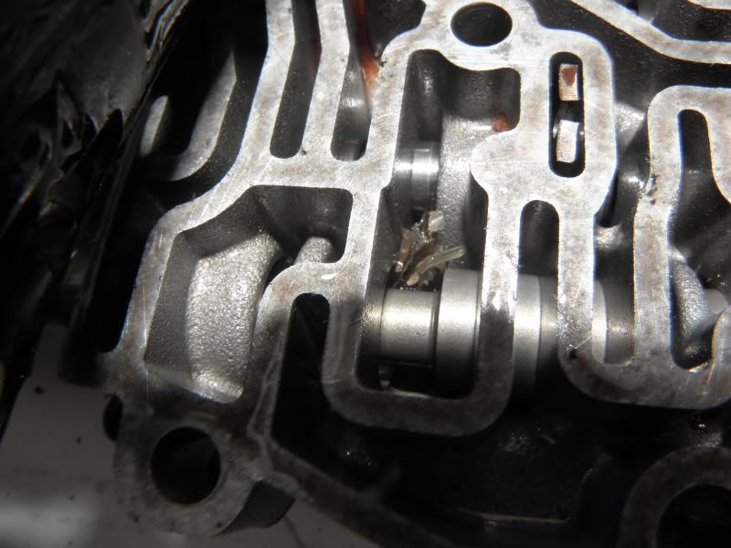

Took the valve body off the transmission today.

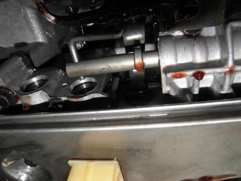

This shaft will not move past the overdrive position going to park.
Removed the three screws and took the metal plate off and found several pieces of what looks like teflon stuck in the oil passage.
Pulled the junk out and now the shaft moves back and forth.
I am sure that it is part of some bushing that is wearing out but this will give me time to save up and get a different transmission.
I need to find a new gasket and put it back together and should be good to go.
No its a strainer screen that gos into the VB, any trans shop will have them in stock.
when they get cloged the pressure pushes it through. you will need to get new VB gaskets.
That would make sense. Now where does it go?
I hope this gives you an idea.
Also be shure you get this right. because i see you have 1 missing next to the shift flute.
Thanks, that helps a lot.
Its done. Fixed a few leaks while I was at it. Thanks for the help Viper Command.
