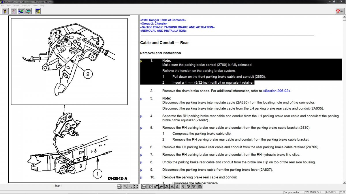

One has to release all the tension inside the park brake pedal actuator (this will require 2 individuals 1. under the vehicle pulling on the cable 2. one in the vehicle pulling on the park release lever).......a small drill bit has to be inserted into the hole where shown to keep the system released while one services the cables

Did you follow the instructions as outlined by the service manual? The assembly is sprung loaded, you have to have that pin in the hole to allow the cable to be tension free. After connecting all the sections one can pull out the pin.

Did you insert the pin into the hole in the pedal lever bracket?
