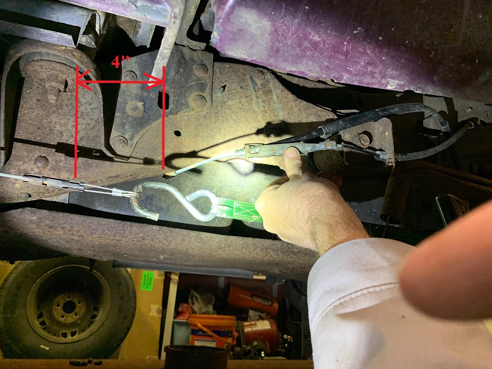

So 8 months have passed and I decided to revisit my issue. I ran he truck w/o a parking brake since last March. I bought a new front cable, exactly the same length as the one in the truck. I bought both new rear cables again but different brand, Raybestos. Both cables are the exact same length as the cables I installed back in March. So nothing has changed. I took everything apart and put it back together. All the same. I used a ratchet strap to pull the front cable as far as it will go. I pulled the bake release. The cable can come no further. I am still about 4 inches from the cable connecting to the coupler on the front cable. I thought for sure something would come out different but I am still in the same predicament. I have 5 new cables, three different brands and I still cannot get it hooked up.

Is the cable in the cab seated through the firewall t the same depth as the old one was?
Are the new rear lines fully mounted/ attached? Leaving them loose until everything is connected might help.
You say all the cables are the same length as the old. So, that should rule out having cables from the wrong wheel base.
The very original rear cables were cut off. So I don’t know how they compare with newly purchased cables. ll new cable are the same length as each other over different brands. I took the old front cable off and it’s identical in length as the new cable.

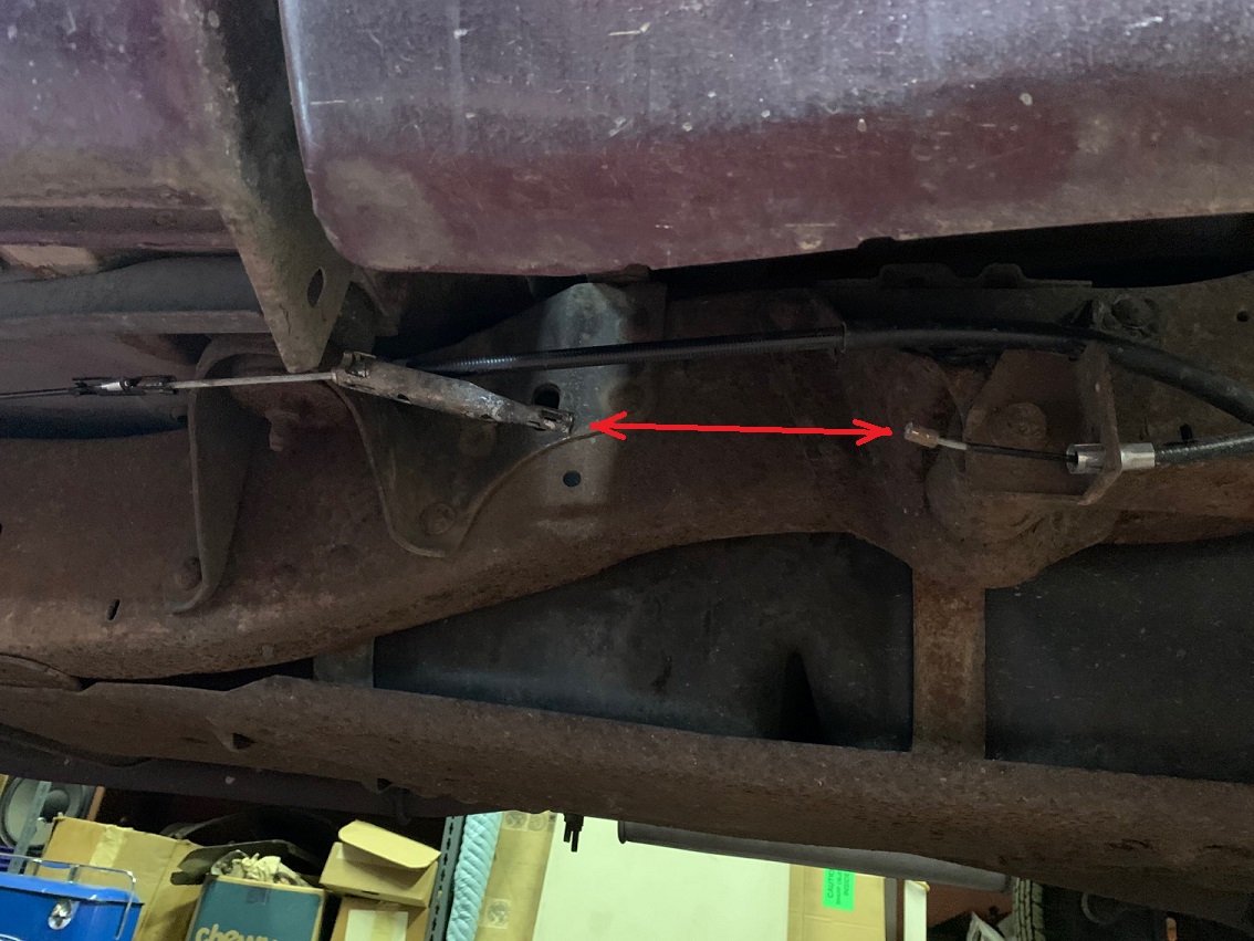

So today I installed the new Raybestos cables, front and right rear & left rear. Despite a lot of aggravation getting the front cable in, I am still at the same situation. This time at the coupler I hooked up the left cable to the front coupler, now I must get the right cable connected to the other coupler (red arrows). For the life of me I have no idea what is wrong? Cables are all the same length over three brands so I doubt it's a cable. Got no clue?
