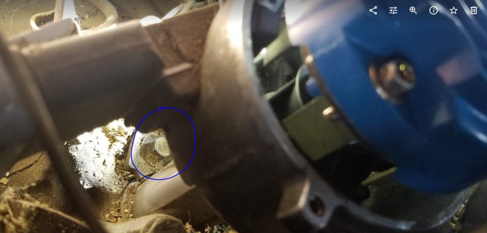

We were able to find the the distributor hold down bolt. Geez who's idea was it to put it way down there!!!
We have since tightened up the distributor and have a pretty good idea we are in good timing.
