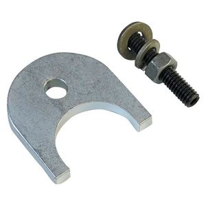

Second question, where is the distributor clamp down bolt? Is it in the same direction as the distrubutor shaft, or does it cross the shaft at 90 degrees to clamp. Does anyone have a picture of it?

The distributor clamp or hold-down should just be a simple plate of steel with a single bolt through it. Much like small block Ford and small block Chevy V8's always had. The bolt is parallel to the distributor shaft. It tightens down on to the hold down plate. Sounds like you may be missing it altogether.
It should look something like this, but not nearly as shiny or fancy. More of a stamped steel piece, but the same basic shape:
If you're missing yours completely, surely we have a nice member here that will send you one.

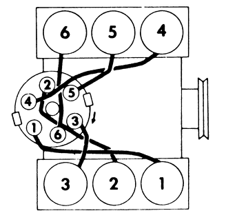

You never said that you confirmed your firing order on your plug wires.. Check to make double sure that the correct plug wires are going to the correct cylinders.

I did confirm the firing order on the distributor cap when I installed the new wires.

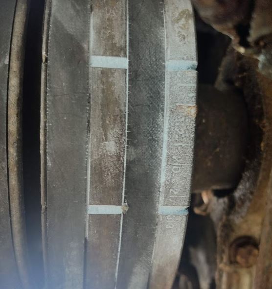

So, I looked at it again this morning.
I found the timing marks on the balancer on the front of the crank.
I set it, best I could tell, to 12 degrees BTDC.
Is it not Firing at all?
Or just not starting?
Could distributor be 180deg off?
Was distributor ever pulled out?
#1 spark firing on exhaust stroke instead of compression stroke is 180deg off
You would rotate engine to the timing mark again
Rotor in distributor will be pointed at #1 wire OR.......#5 wire
If on #1 lift up distributor and turn rotor to point at #5
If on #5 lift up distributor and turn rotor to point at #1
This changes spark timing 180deg
