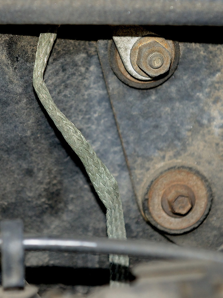

Can someone please tell me where this wire grounds to on their motor?

I've recently ran into a wiring problem of some sort and am trying to locate a short or grounding problem somewhere in my harness. Upon looking under the hood I dicovered that this entire chassis grounding strap is missing.
I have'nt had time to really start checking my wiring harness with my voltometer yet so I'm starting with the very basic visual stuff. If I have to I'm considering throwing the 2.5 harness in that came with the motor I just swapped because I checked that out last night and all the sensors at least has continuity. It looks better then the one in my Ranger as well.
Can someone go take a look see real quick and let me know where this is grounded at PLEASE??? Thanks.

Here is mine, the other end is grounded to the back of the head:
yea, it should ground on the back of the head, take a look at your old engine, it may still be attached to it from being ripped out when the engine was removed without disconnecting it hehehe.

Yeah, I'll have to take a look see because I'm having some sort of electrical mishap right now. Actually that ground has been off of my truck for a loooooong time but I'm desperately looking for a answer right now. Later.

That strap bolts to one of the lower intake manifold "stud bolts". Sould be the bottom one towards the rear.
Ok, thanks. I believe you're right. It's on a bolt that has a stud extended out in order to bolt it onto right?
This is a ground cable right?

Yup.
