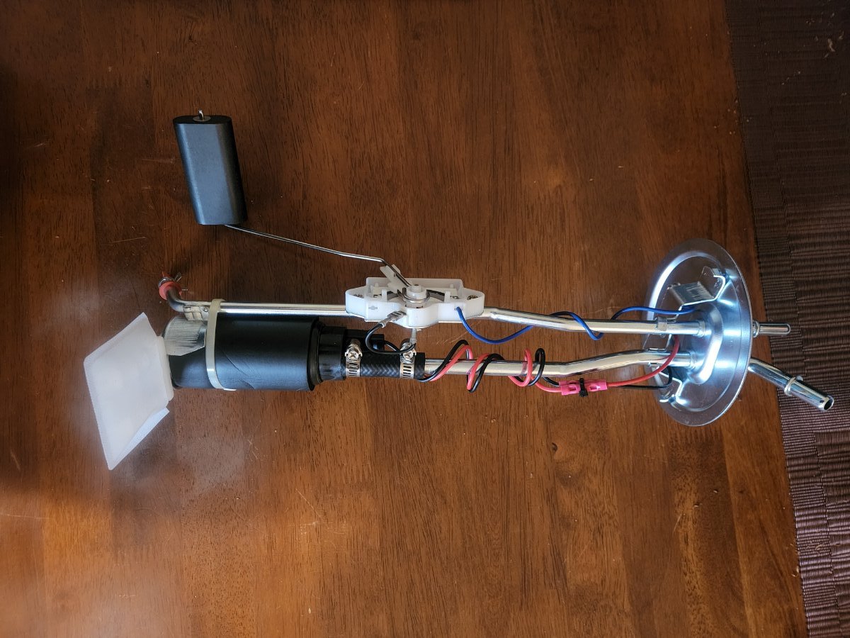

thats a b2 pump and a mustang pump....
been using the mustang pump in those carriers since the early 90s...pretty straight forward.

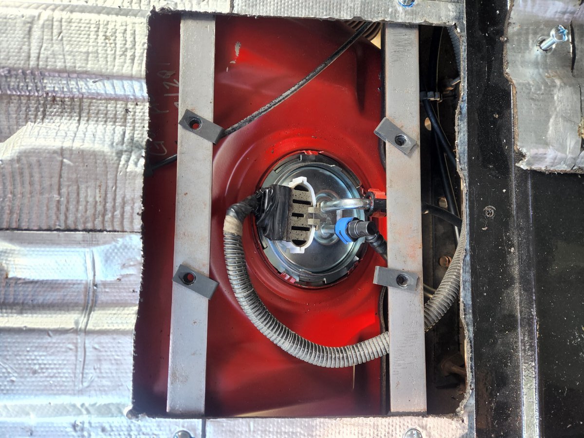

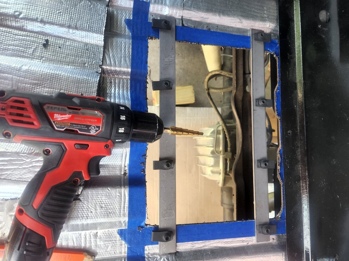

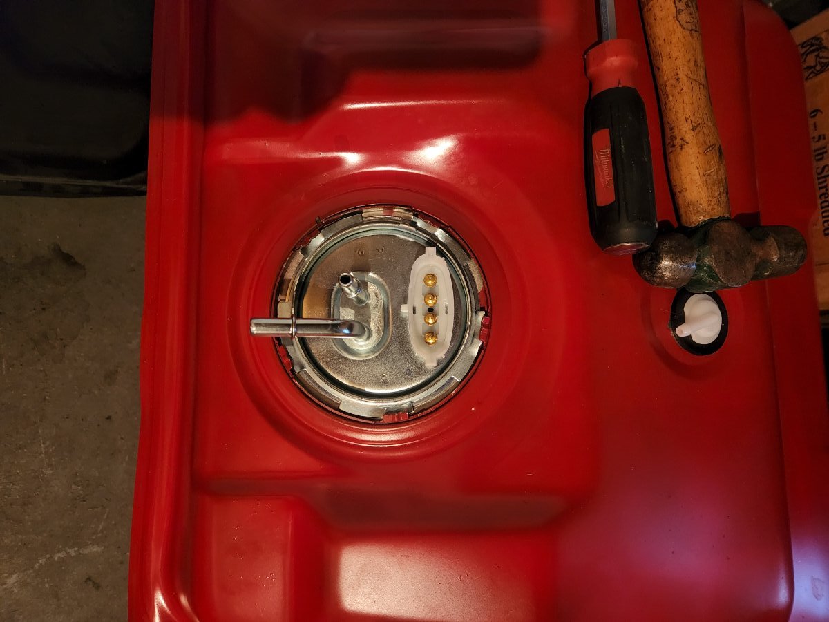

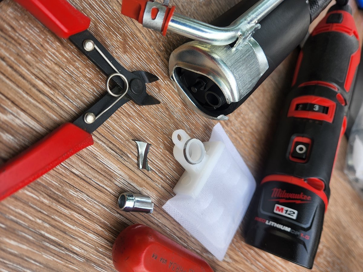

The cleanest way I have done on these is to replace the low pressure pump with one of these:
It's not a 100% bolt in pump and requires just a couple minor modifications to the sending unit but then you can delete all the unnecessary junk in the fuel system. I did that on my old '88, my '86, and a couple others.
My way of doing this mod...

What exactly did you cut off? What year pump? The pics are great but I need context.
Sorry... I kinda thought they would be self explanatory. All the details are in my G-Unit build thread.
