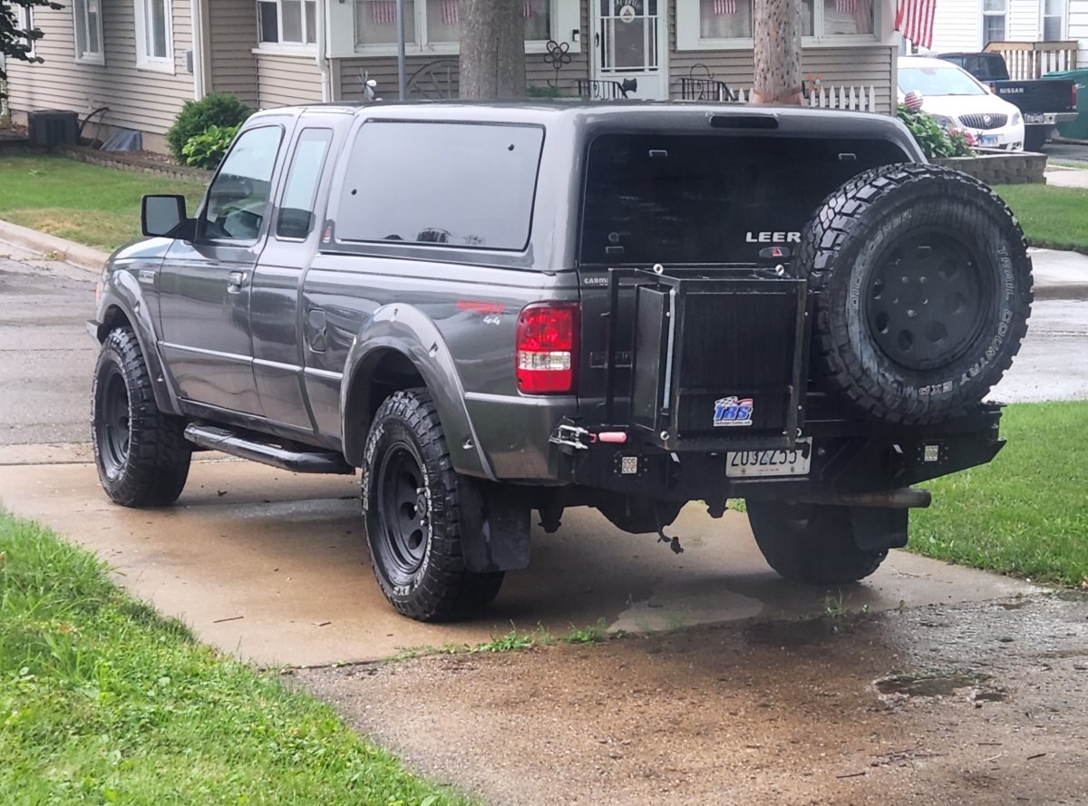

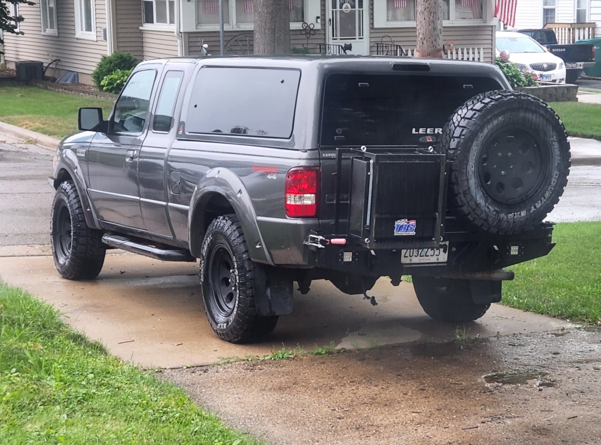

That's 32's on my 06 before suspension work. 265/75/16's on 8 inch wide with 4 inch backspace. It worked but I never really flexed it.
All these trucks are different... your results may differ.

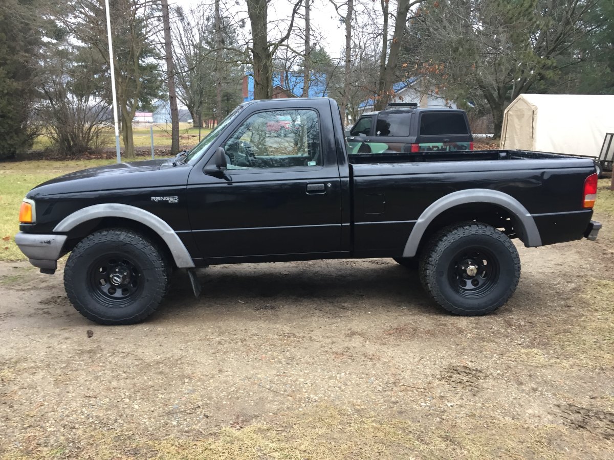

My 95 with 31s, 4" backspacing on 15" x 8" rims , no lift, sagging front springs. No rubbing but I haven't taken her off any sweet jumps.
Thank you. What wheels are those, I like them. Do they work with manual hubs if you know?
Thr rims are Cragar soft 8s. I bought them thru Summit Racing. They have a good size center bore with plenty of room for the hubs. Those are manual hubs on my ranger. Auto and manual are the same size. I generally use McGregor tuff nuts for lugs. Spendy but they last forever, are one piece so they can't expand and split. Those ones are 13 years old, run in the winter salt and are rust free.
