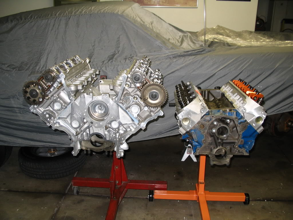

This is a 4.6 next to a 302. This is the primary reason it's a bad swap candidate.

A measly 2v 4.6 is wider than a 460...
