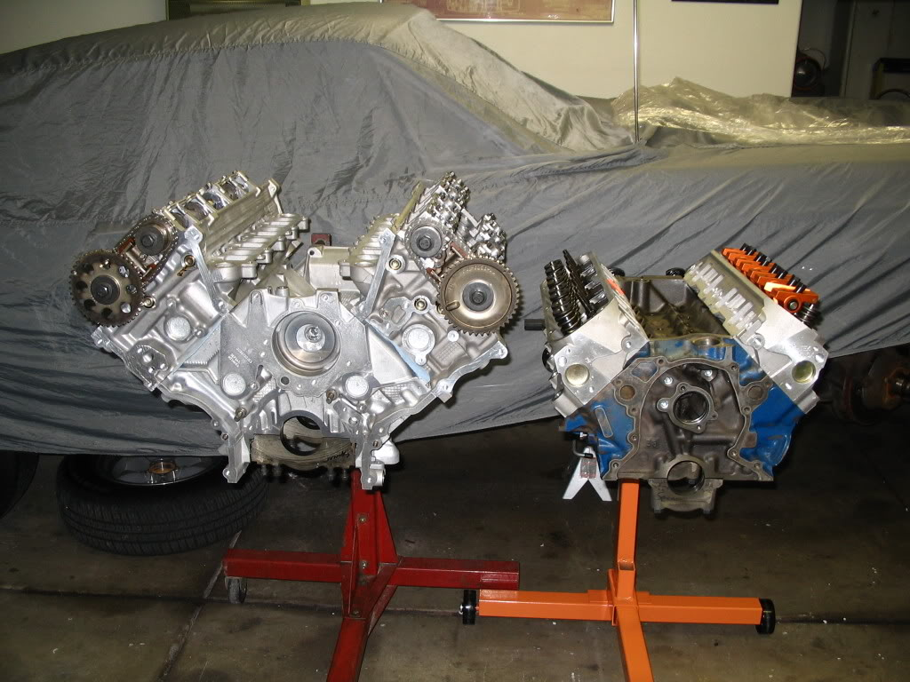

When that comparison picture is examined .... WHY would anyone want the head ache of attempting to swap that massive block into the small space? All i see are problems everywhere.

To be fair that is a DOHC one pictured, a SOHC wouldnt be quite as bad. Still wider than a 460 though.

This is a 4.6 next to a 302. This is the primary reason it's a bad swap candidate.
Seeing is believing, but, I already knew since I still work on 4.6L and 5.4L trucks from time to time :)
