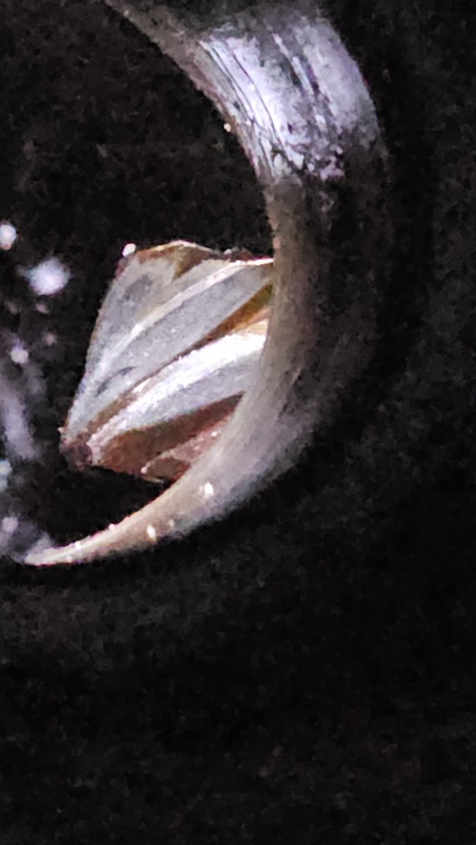

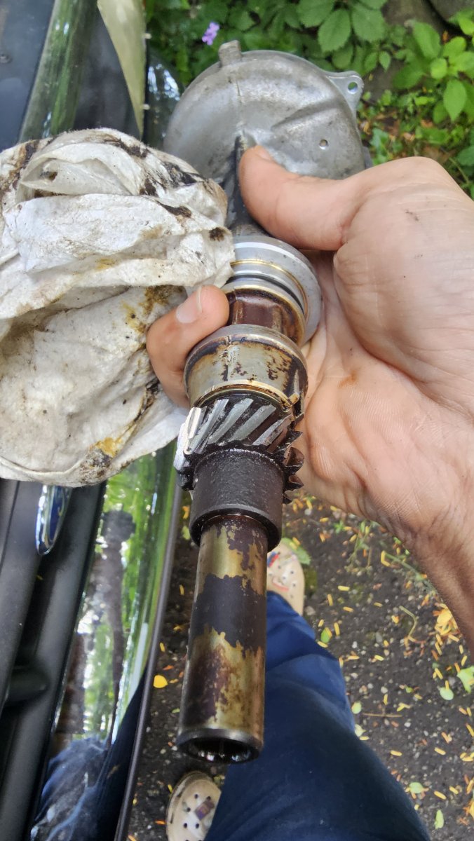

my camshaft damage the gear and distributor gear .. my question is is there anyway to replace the camshaft without removing the entire engine? Posible? Will appreciate the help

1993 Ford ranger? What engine? Most engines you can pull the camshaft if you take the grille and the radiator out and move the A/C condenser out of the way. Whatever it takes to give you room.
Unusual that the camshaft did the damage. Usually the oil pump locks up, and that damages the cam gear and or the distributor gear. Most of these engines, the bottom of the distributor drives the oil pump.
Thanks for respond.. thats why its weird looks like 2 gears overheats (damage] and doest have oil flowing into it... what u think should i do? Where should i start ? Oil pump? ... ok ill take the advice removing the radiator and ac and so fort

Update on oil pump turn it into drill does it matter turn clowise? Counter? I tried it and does it normal the drive oil pump wabble? When i spin it looks like oil not coming out.. appricate your help
