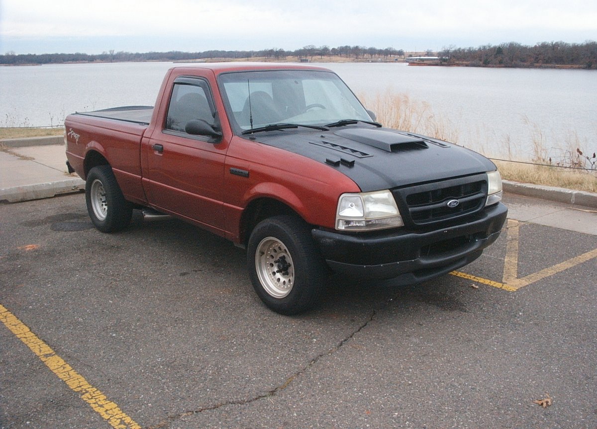

Pic below, the center scoop has 30 1.5 holes underneath it, all over the intake manifold, throttle body and five of them run along the steel tube connecting the MAF to the throttle body. The two small scoops are directly over the large Spectre stainless steel mesh cone filter. The heat vents are fully functional, and the heat that exits them is considerable, even just idling. I've been reading up on them, and it ends up that if you put a small spoiler in front of them, they are even more functional. You have to break up the airflow overtop of them, which then allows the high pressure underneath to exit easier. May be doing that soon. Oh, if I thought that intake was loud before, you ought to hear it with those hood vents in place! I can hear the intake over the no muffler exhaust easily when my foot is on the floor.
