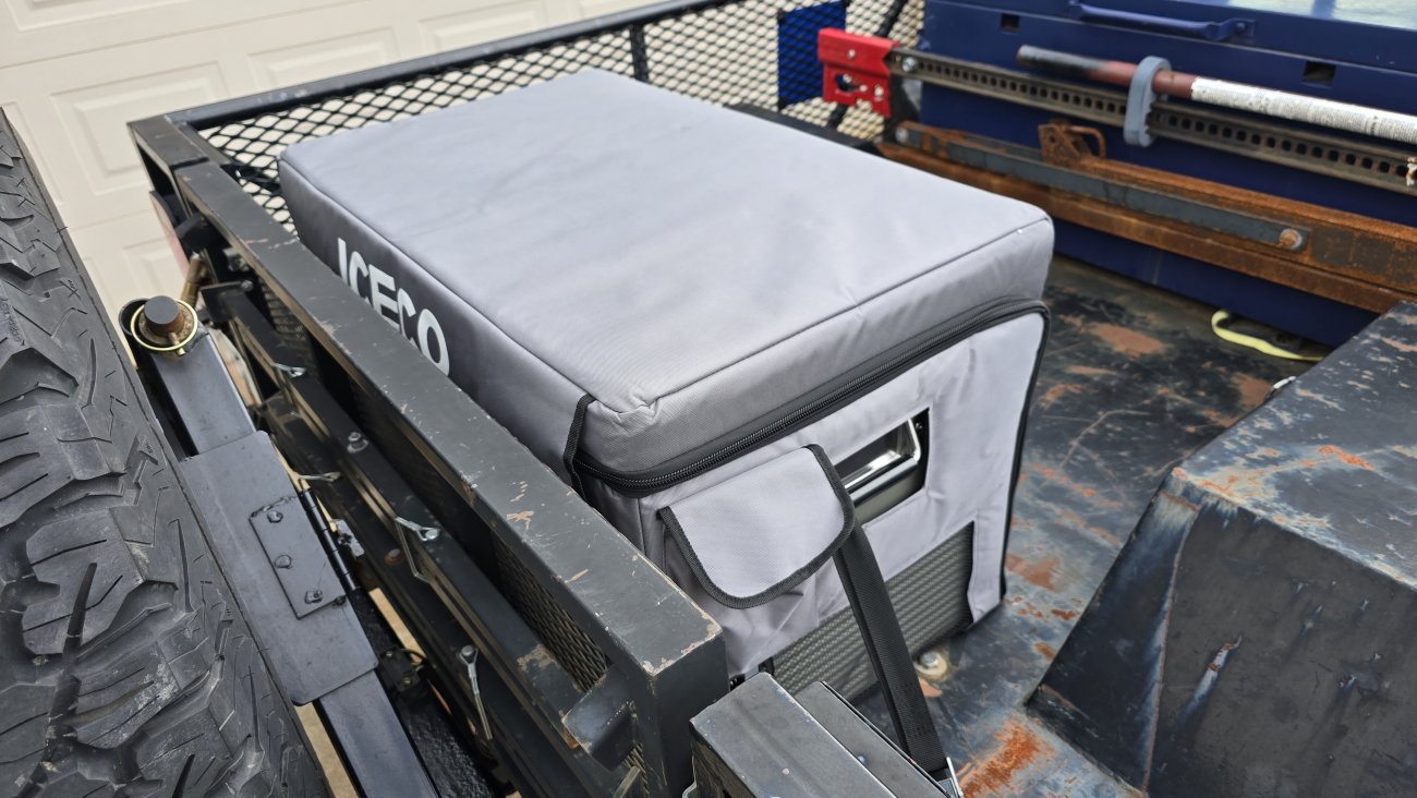

I have an open bed. But, so far, I've been keeping the refrigerator in the house when not needed. Mine is built to be out in the weather. It comes with an insulated cover. But it's not a cheap machine. Watch for sales.

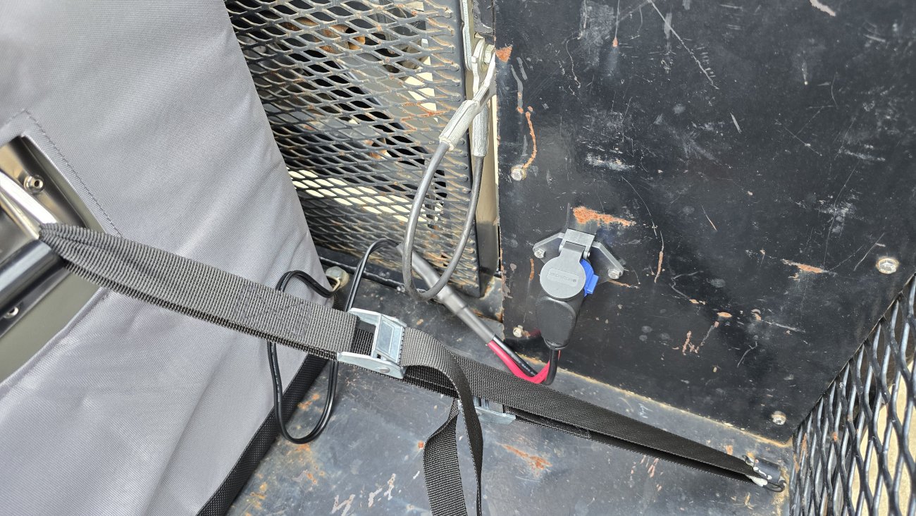

I bought the Explorer Bear 40L fridge, now I just have to figure out how to keep it running over night while I'm camping. The 12V power supply going to the bed doesn't stay on all night. I forget how long it stays on before it shuts off. I actually extended the time, but it's not going to stay on all night.
I'd like to switch it to something else to power it overnight such as an auxiliary battery or a portable power supply. This thing pulls 2.75 amps (35.75 watts) on Eco Mode and 4.45 amps (57.85 watts) on Max Mode. But then their website says "ENERGY CONSUMPTION: 2.8AH/H AMBIENT@77F, INTERNAL@0F ".
If I use an auxiliary battery I need a way to charge it during the day when I'm driving. Either a DC to DC charger, or a dual battery solenoid like I had on TRS-1 back in the day.
A portable power supply would be nice to have, and I could use it in other vehicles or in the house if the power goes out, but then it would need charged back up during the day. I could probably just set on the back floorboard and plug it into the 110 (400 watt) outlet in the back of the center console and let it charge during the day while I'm driving. I could even add an inverter to the toolbox in my bed so I could charge it back there. I'd have to run a separate wire to it from the battery and it may seem redundant or weird versus having a battery and DC to DC charger back there, but it would free up cab space, an inverter in the bed might come in handy, and you can find them fairly cheap.
I could also look for a power supply that will charge from a USB cable. That might charge it driving around during the day.
Harbor Freight has a Predator 600-Watt power station that I think would run my fridge all night. Jackery has an 800-Watt power station that would definitely power it through the night. They actually have an 800-Watt and a 500-Watt but they're the same price.
Then there's always the solar option, but I don't really have any desire to add a big solar panel to my truck.

Keep the refeigerator in the shade if you can, it will use less energy than if you let the sun hit it.
