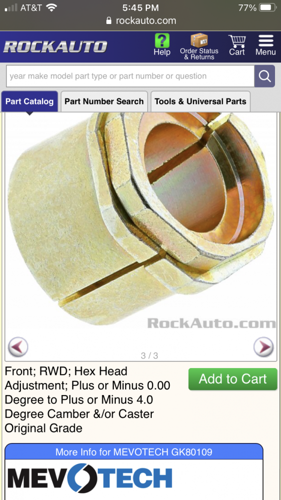

Ok. I never encountered one with a stop. You can buy replacement bushings and they have different ranges of adjustment. For example, you may have bushings with +/- 1.5degrees of adjustment. For all those washers you added, you will need one with a lot more adjustment range, like +/- 4 degrees. When you do that, it changes your caster also. But they make adjustable bushings that allow you to correct caster independent of camber. Like this one from RockAuto
First one I've seen with the odd shaped. The replacement is set at +-4 degrees, turn the middle and it set the caster and camber at the same time, in a perfect world. I would say one with +-4 degrees don't take much movement to get noticeable results. Guess mine pops out like this one pops in. soaking in PB now, wonder how hard it is POP out. Dirty

To rotate the bushing in your pic, they have to be pulled at least part way out. Theres a key that indexes them that fits into the little notches, you've gotta pull em out far enough that key clears before you will be able to turn it. Either way, they look like they're pretty close to 0 degrees, so rotating them wont get you much, if any, adjustment. Youll want to buy some 2 piece adjustable bushings similar to the ones in the pic above. You've got a d28, pretty sure the one in the pic above is for a d35, but it's the same concept
