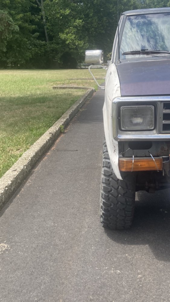

I'm operating on a non existent budget for a while and considering doing a DIY camber adjustment of the wheel just to get it upright again to prevent weird tire wear before when i go for a proper alignment later this year at a place that is reputable with custom suspensions.
For now, am I out of my mind thinking that I can lift the passenger side a number of times and adjust the bolt/nut a little this way or that until the wheel is vertical when dropped down and under load?

The wheel is noticeably leaning inward up top, outward up bottom, as pic'd here. Not horrendous but not good.
DON'T MIND MY STRAP-ON BLINKERS!!! I'm half way done converting from 2nd gen nose to 1st gen and don't have the valance or signals yet.
That "nut" you are referring to is an eccentric bushing. As you rotate it, it pushes the top of the wheel in or out or forward or back. Concentrate on camber and just take whatever caster you get. They make a 2 piece adjustment bushing that has one eccentric inside another. That gives you more control of caster almost independently from camber. It takes a while to get used to them.
As you adjust the camber, it will affect the toe. So you have to double check both of them until you get it dialed in.

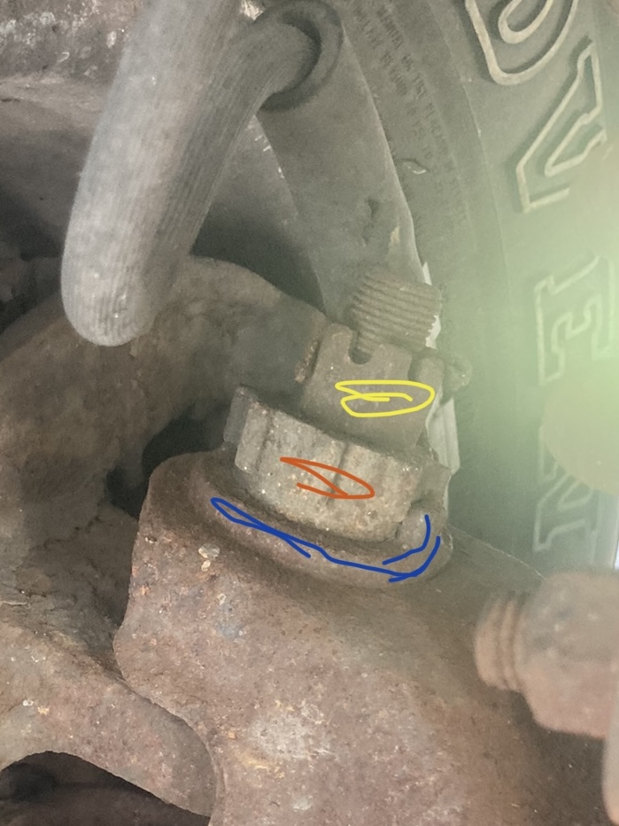

Haven’t tried camber/caster though. Attached is a zoomed in pic of the adjustment system. I’ve highlighted what appears to be three distinct pieces of the equation.. yellow nut, orange nut, and blue which is some kind of ring piece around base of orange nut.
I think the yellow nut needs to be fully loosened first of all to allow any adjustment of the larger orange nut which is in fact the camber nut.
Does this orange really affect caster too? Seems from other videos that there are two adjustment points on a wishbone shaped bar that sits horizontally above this area, and on that bar there’s a point in towards front of center and point towards rear of center, so it makes sense to me that adjusting either point will also adjust caster (and also toe), but in my truck I’m not sure I see that system.
In any case, am I correct about the purposes of the yellow nut and orange nut?
What is the blue ring? Is that not supposed to move and is just part of the fulcrum system for orange nut? It looks a little strange becsuee there’s a little extra nub that shoots up and appears to limit motion of the orange nut, so I’m concerned I won’t be able to turn the orange nut at all, like this is a permanent factory setting for camber or something.
I’ll go ahead and get some PB Blaster on this stuff in the mean time and hopefully I can adjust this stuff later today once I’ve figured out what the hell im doing.
Thank you!!!
I never dove that deep in a Dana 28 but I know they're slightly different than a Dana 35...
If it works like I expect it would the yellow holds the orange to the balljoint and the blue is part of the axle housing to keep the orange from turning. The Orange part is the eccentric so it moves the ball of the upper balljoint around in a circle, if you take the top nut off you will likely be able to see the offset. Moving the balljoint changes everything

You need to loosen the nut (yellow), then you'll have to break loose the ball joint stud taper by beating on the axle beam right next to the bushing with a hammer (or maybe thread the nut upside down onto the threads to protect it, and then beating downward on the stud itself might pop it loose... It can potentially be a PITA). Once the taper is broke free, you lift up the bushing (orange) past the nubs, and rotate it to adjust the camber (caster), then push it back down, engaging it with the nubs.
Because of the older D28 design, there are only 8 positions you can put the bushing (if you get the above-mentioned 2-piece eccentric bushings, the amount of available adjustments becomes much greater).

This makes so much sense now, thank you! I was about to chime back in here and ask if perhaps the orange nut was in fact only course positionable in increments due to that little blob of steel on blue ring pressed against a face of the orange nut. So yeah, it is.
No, the drivers side wheel is not off in camber, to the eye at all. So I have to just tackle this wheel alone.
So the “orange” bushing-nut thing is NON threaded? The goal is to just free it up, then lift it up the shaft enough and rotate and put back down in new position? I wonder how much tension there will be. Maybe I’ll set something up on the ground to press the bottom of wheel inward towards truck so that it’s easier to turn the bushing into that direction of camber that it needs to go.
I’m still struggling to understand how this bushing effects caster though. Seems like caster is permanent/fixed. I don’t see any means to moving the wheel forward or backward in relation to front of vehicle. Does anybody know if that’s the case with this axle design?

In the rust belt....it can involve destruction.
If you have some heat and a air hammer... give it a try and it may free up.
Otherwise I just rip it all apart and antisieze it all back together with the good aftermarket unit. 2.25 or better bushing. It's easier to deal with using a 1 1/8 wrench later.

“ 2.25 or better “ meaning a physical dimension of the orange bushing nut?
When you say destroy the parts/system, you’re saying demolish out the whole stud / ball joint and also orange bushing and yellow nut? Haven’t looked at how the ball joint fastens to wheel system below yet.
I assume the “blue” ring with tab on it should remain and this tab will mate up against faces of a new orange bushing nut?
The adjustment range of 2 degrees.
