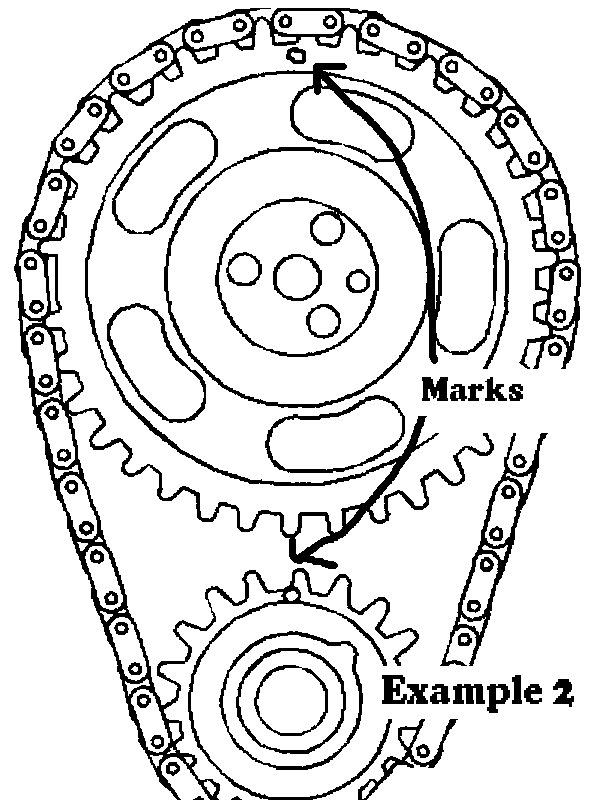

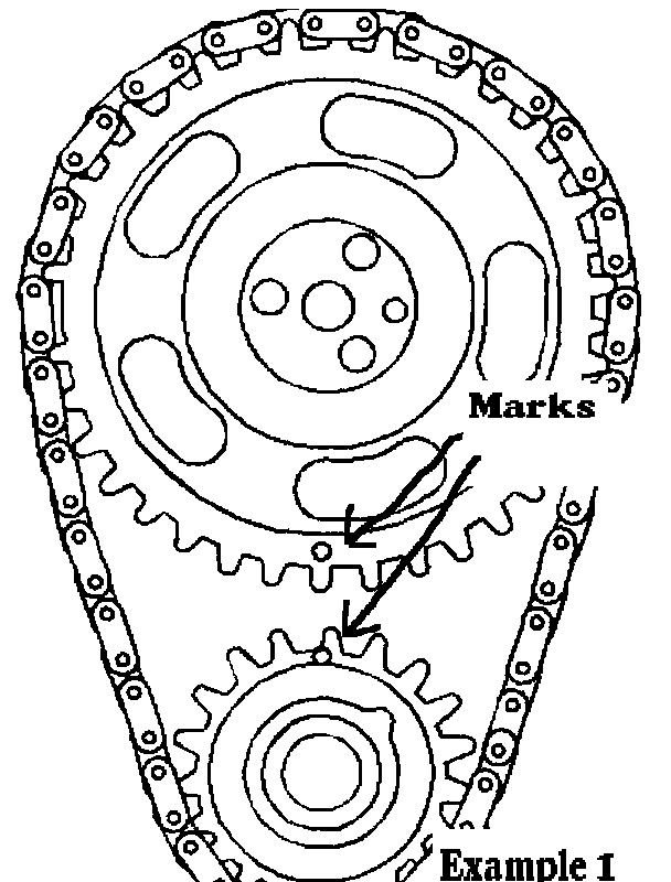

This was my question, better organized. Which drawing represents TDC on compression stroke?
I'm assuming your drawing explains which is which?? But my Haynes says the left drawing, timing marks closest to each other. My Haynes cautions about making sure the oil passage in the camshaft bolt is clear of obstructions. It also describes checking for timing chain stretch.
