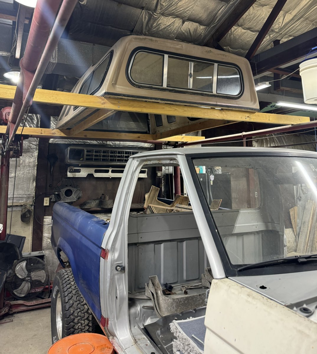

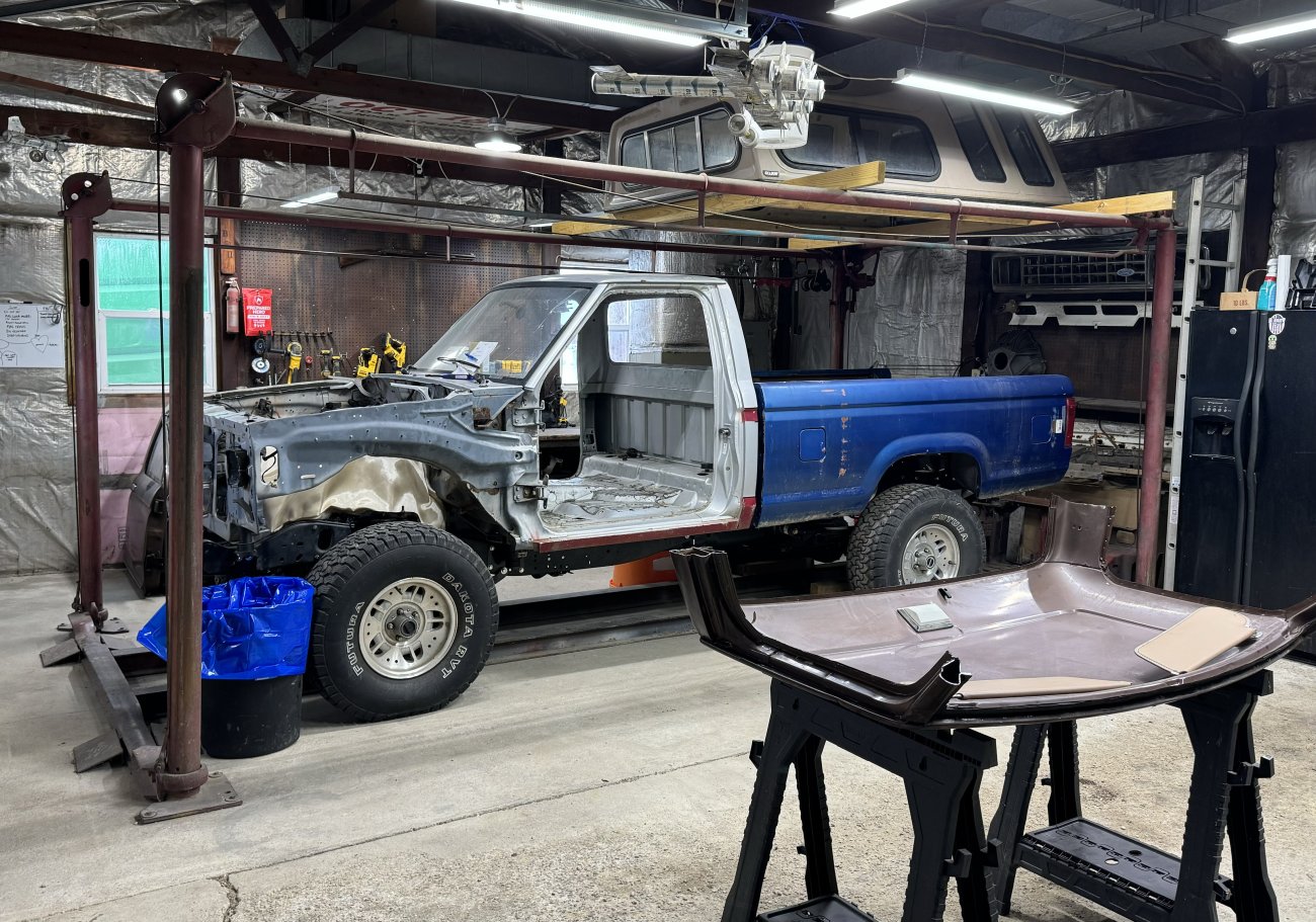

I think if I was you, I would try removing the roof skin from your truck before you do anything else. If you can get the skin off fairly easily, replace only that with your donor piece and patch in little pieces on the inner skin. I really think if you cut the whole roof off yours and try to weld the pillars back together, you are going to have a hell of a time getting things straight, square and lined up so that the windshield and doors fit right. It is a LOT easier to drill out a bunch of spot welds on your skins than get everything lined up with a full roof swap... and you'll have the opportunity to fix that dent in your donor panel while the skin is off.

I am going the route of replacing the headliner/rear window trim in only the necessary patch pieces. The roof skin is solid so don't know that I will remove that but a compressed air bath and coat of fluid film post weld in between roof and headliner is a must - also have a donor cowl for the interior bulge at least...the firewall side will have to be custom. Damn rodents.
Bought some of these cool little butt clamps for the one sided access on the headliner since I am not planning to remove the roof skin.
Oh, good call, for some reason I thought you were replacing the whole roof skin. Patching in a few spots will be a lot easier.
