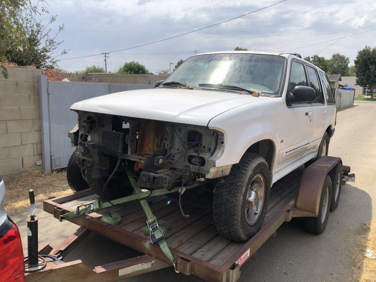

After some lamenting, aggressive stripping of the explorer, some angry googling and killing a bottle of Whistle Pig.
I have a new plan of attack..... the difference between LDT1 vs LDT2 Is loaded vehicle weight not GVWR.... and LDT1/2 rolls up to light duty truck.... which light duty truck is anything under 8500 GVWR....

Yeah, the plan is to continue to swap. I will have to try and prep as much as possible prior to the actual swap. I will look at the verbiage right before and if has not changed then I’ll try and swap as fast as possible and schedule an inspection.
I hit some minor set backs already, two waterpump bolts snapped in the block and 3/4 corner lower intake manifold bolts snapped in the block. Should have just left it alone...... one of the waterpump bolts was snapped from the previous owner. Then the stupid plastic ring on the injector fell down in to the intake mani when I was taking the injectors out to get cleaned, and I could not get it and was trying to get closer too it. I also wanted to get the intake cleaned of all the sludge inside it.
So I have a very basic 2wd 2000 2.5L manual truck, it has AC but nothing else power The 2000 2wd XLT explorer 5.0 had power everything and seems electronically different enough to present problems in the swap. If I were in “free” state this would probably not matter and I would just have permanent CELs or just delete them. However, the amount of stuff I’m going to have to swap to make the unedited ECU rom work is significant. My truck is rear ABS and Im going to have to convert to the multichannel unit from the explorer, because if I don’t it will cause CELs.
Then there is the cab side harnesses.... I’m pretty sure I might have to open up both harnesses and blend them. I’m not even sure about GEM at this point, I really need to find the full pin outs for all the harnesses for both vehicles.
The donor explorer had the keyless door code entry, what is it tied to GEM or PATS? I grabbed it too. I grabbed everything that was different off that explorer.
I know that people say that this is a 95+% plug and play swap, I’m going to say that’s largely depends on how similar the donor and recipient are in terms of options. Based, on my current assessment I’m dropping my swap down to like 60% and adding convert to plug then play. But this is all to go through legalization.
