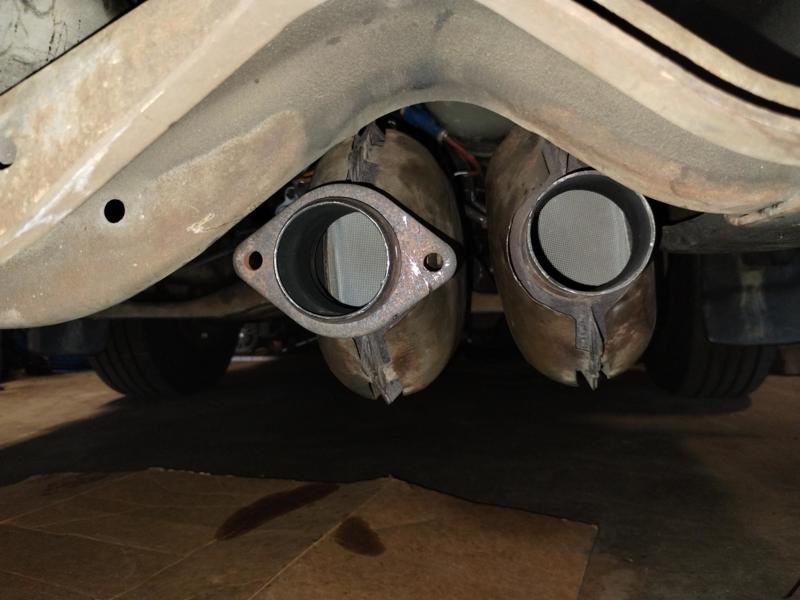

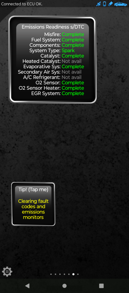

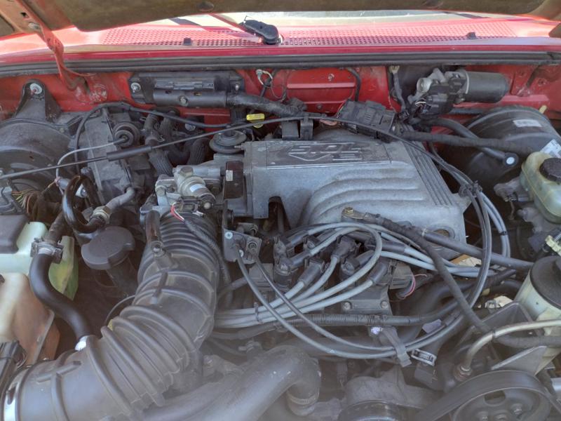

I called the Bar for an appointment, and they gave me a checklist to follow and asked for some photos of the emission components in place, once I had completed that I called them again for a face-to-face appointment to check out the truck, it took about 90 mins to complete.

I called the Bar for an appointment, and they gave me a checklist to follow and asked for some photos of the emission components in place, once I had completed that I called them again for a face-to-face appointment to check out the truck, it took about 90 mins to complete.View attachment 113550View attachment 113551View attachment 113552
Did you have to have the Mountaineer cats, or would they accept CARB certified universal cats?
I'm not in Cali and never plan to be, but want to keep the truck 50 state legal if practical since who knows what the future holds. I do need to replace my exhaust from the headers back. Headers probably need to be done too, but Torque Monsters are on my short list to replace the OBX. Keeping cats won't be cheap, but I intend to keep the fronts at least and add rears if I ever move to a place that requires it.
Hi Guys, The mountaineer was completely stock and I ported everything over to the ranger, the exhaust was cut between the cats to move it away from areas it was touching and then welded back up..
If the cats had the Cali Carb part numbers on non OEM , I'm sure they would be accepted.
