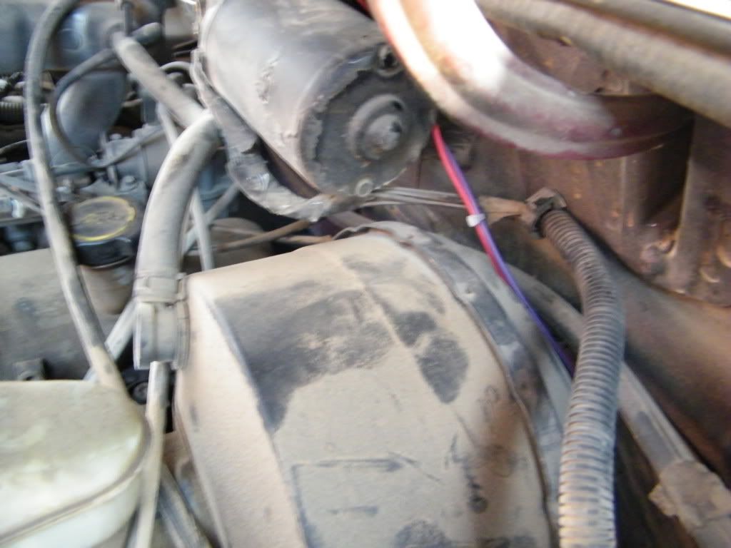

sorry, lemme reword: what did you use to make the push button starter
i just ran 2 wires from the solenoid, through the firewalll and to a push button from o reilly autoparts. i can make a vid tommorrow if you want me to of it, oh and you should sub, im gonna be makin lots of new vids of the truck
i did the same to my b2. push button where the sun visor was.

yea subscribe to my youtube channel, but yea, it worked out pretty damn slick (iif i do say so myself lol) and mine is right under the steering colomn mounted on the panel you pull of to get to the fuses, but still have enough wire slack to pull it down to get to the fuses. but yea ill check out your build thread
ok so here is how my push button start is rigged up, goes to the 2 postes on the solenoid, routed behind the motor, and goes through a hole in the fire wall and then goes to the push button, its actuallly a pretty goood one, paid $5 for it.

the key has to be on the on position, or else it dont get spark, the ignition switch went out so i rigged this up, and it works pretty damn good
