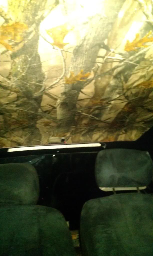

Do you have any pics of your backseat setup? That thought occured to me, but I wrote it off assuming there wouldn't be enough headroom.

how did you do that? looks like there would not be any room

Sorry for the crappy pics, just saw the thread and went out to take the pictures, Kinda hard to get quality with 5% and double 5% tint at night. The seats look like theyre out of a camry but came my ranger when i got them. Someone made some brackets for it them to fit like stock seats. Al me and a friend did was take out my rear, align these up and drilled where we needed to bolt them down to. We didnt change the brackets at all so its still a front seat bracket, just had to push them down a tad. and NOTE: the way the front seat brackets are set up, you have to swap the seats around, reclining position in both seats is in the middle
As far as headroom goes, if you're short its perfect, if you're tall, then reclining is the only way. Im 6'2" and 275 and id rather sit in back then drive haha
