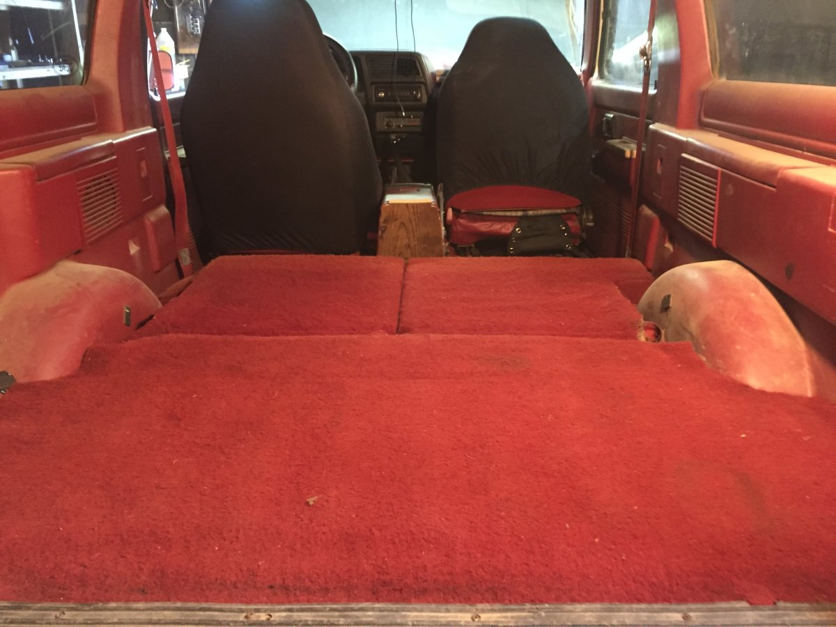

That's pretty slick... I was having a hard time visualizing what you had going on. Still leaves you lots of room behind the front seats for... stuff.
Yes lots of room. Still have all original cargo area plus under and around the spare. I usually have a jack and lug wrench and some recovery straps and such in a canvas bag. Emergency blanket and some snacks. Even a small cooler. No kids at home so no need for the seat.
When I looked at the picture... I said a duffle bag full of your recovery gear stuffed under the spare.

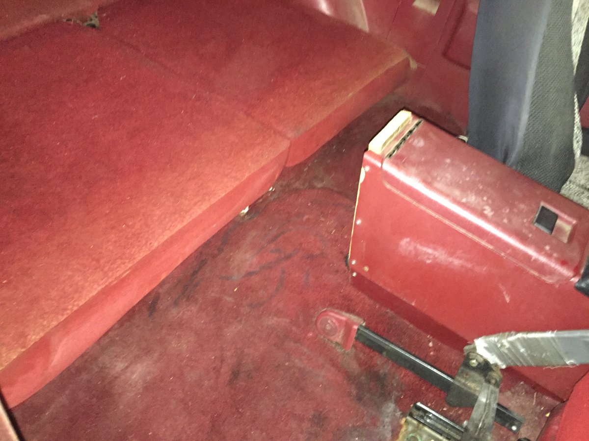

This is my 89 with 1/2 seat delete. I only removed the bottom portion. It maintains a nice flat area for cargo but allows for storage behind the front seats usually occupied by the folded forward rear seat. Notice my shortened center consol. With 3” body lift and M50D R1 my shifter was hitting my coffee cup. Had to move it rearward and shorten it As it wouldn’t allow rear seats to fold forward. Then I removed seats😜
This is my 89 with 1/2 seat delete. I only removed the bottom portion. It maintains a nice flat area for cargo but allows for storage behind the front seats usually occupied by the folded forward rear seat. Notice my shortened center consol. With 3” body lift and M50D R1 my shifter was hitting my coffee cup. Had to move it rearward and shorten it As it wouldn’t allow rear seats to fold forward. Then I removed seats😜View attachment 67165View attachment 67166
