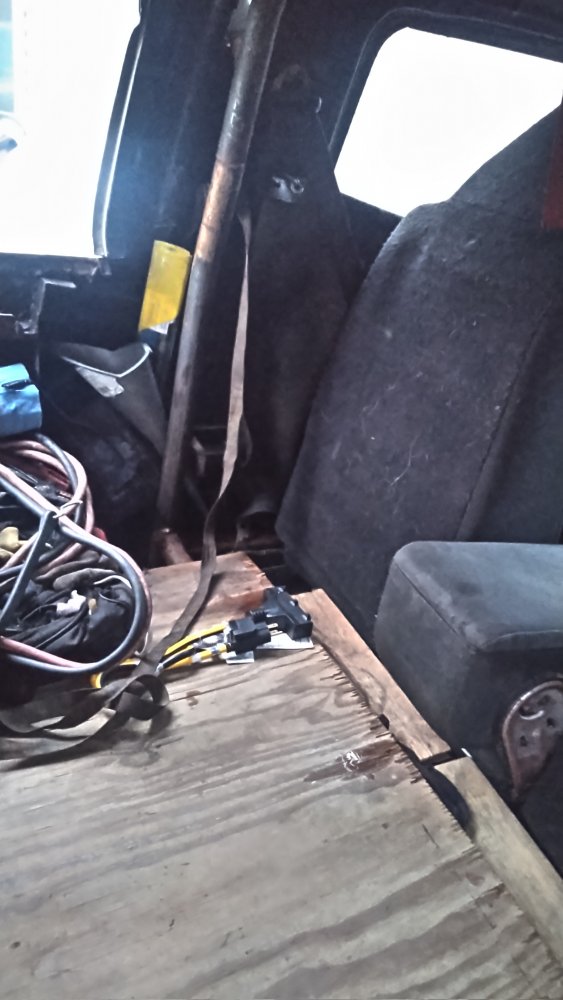

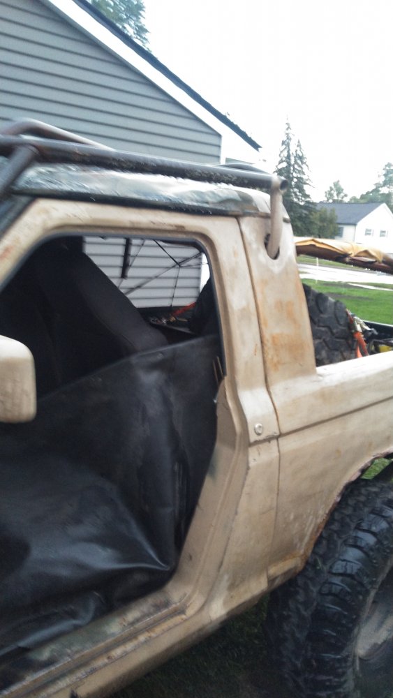

That is how my rig currently is. But I don't have to build the floor up...the cross bar for the cage rail goes under there...I just pull the board up..tools...oil.... gallons of coolant ect are under there and in the wheel Wells.
Not sure if we will get a cap made...likely just put a wall up this winter so I have wheels.
But I have a herd of grand kids so I want more seats.
Our first bronco 2,s were always packed with kids... And I want the b2 and ranger to be at least 4 seaters...way more fun.

Look at this guy...bragging about fancy smancy carpet.........even upgraded it with dirt, grease, and dog hair .... Well at least I have dirt and dawg hairz
It's still raininzz...I just pulled it in off the street for the night

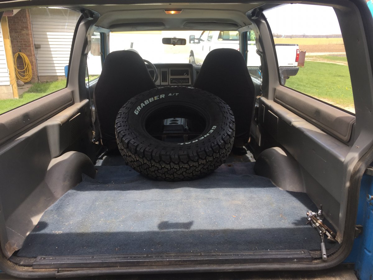

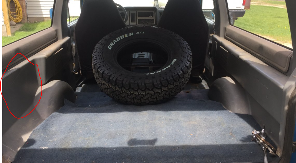

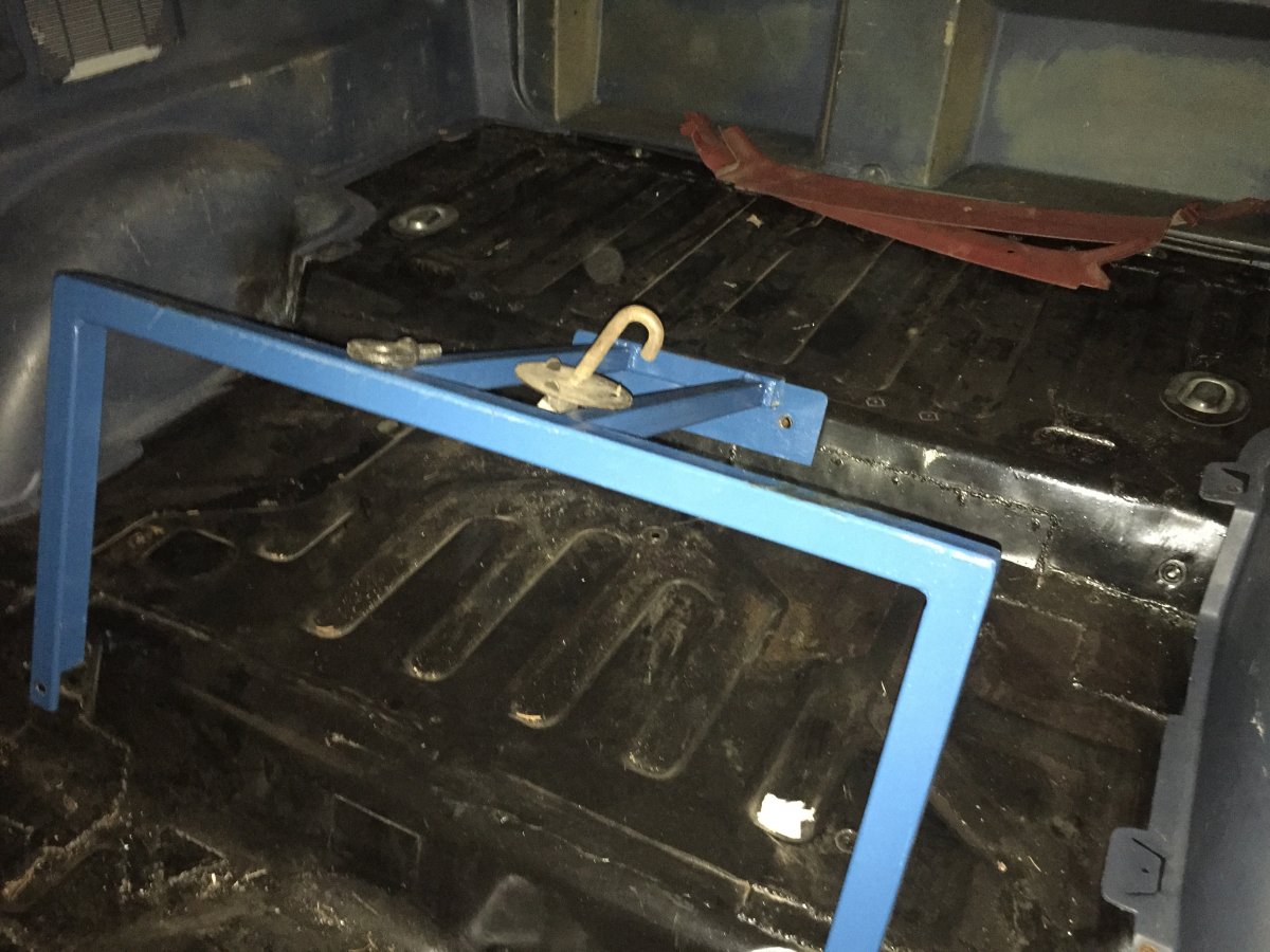

This is one of my 85 BIIs. Rear seat delete. She had a huge crack on the rear gate from someone prior to me hitting the spare tire mount. I had a spare gate from a rig with inside spare mount and swapped it out, but with inside spare there is not cut out for the exterior type spare mount. So I made a new rack inside using seat bolt locations to mount to the floor. This pic is before I had a rim for the spare so if you notice it’s just laying on the mount.

That there opened my mind to actually putting the spare inside. At some point I would like to do a hoop behind the front seats... maybe I build my tire carrier off that?

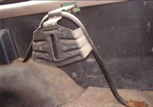

Could you use the full-size mount on the inside of the LH rear wheel well? That has one factory tool box on that side and 2 on the right. Could fab one or cut the tube off flip it 180, weld back and catch the inner fender in front with the short side.

I like the idea of the spare standing upright... sure would take up less floor space.

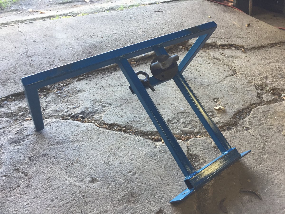

I had a BII with interior mounted spare but I never saw a spare attached. I have to speculate it was for a doughnut type spare. It had an extra bracket mounted behind the interior panel driver side behind the wheel well with an additional bracket on the outside the panel to secure the spare. I was going to scavenge it for my other rig but it was so low and small my 235x75 15 wouldn’t even fit. Strange the rear hatch didn’t have the cut away around the upper hinge where the swing out type mounts. I used the door on another rig that I removed the swing arm from. Here’s a pic. The mount I made bolts to the old rear seat mount locations. A couple more pics. Truck with interior spare has since been crushed by a falling tree. Took all the parts I wanted and sent it to recycling
