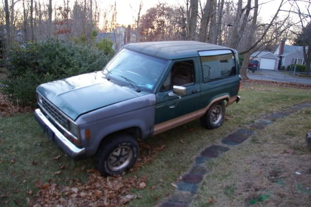

Second, The 2wd has the nice wheels on it. Are they the same as the 4x4 or does the 2wd have a different wheel that looks the same? The wheels it has are in the picture below.
The 4.0 will physically bolt into a BII, including trans, but I wouldn't trust the trans in your BII to not puke out after a week or two (ie... you need a M50) The wheels are the same... The 2wd just has covers over the hubs...
