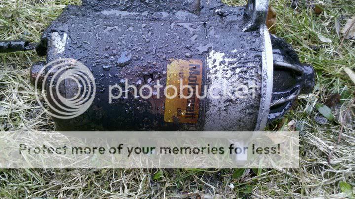

well i managed to get the thing home today but with major problems , all of a sudden the starter solenoid just buzzes , does not turn over , i am trying to chase down the issue , but no luck , replaced the battery , cable ends and solenoid , all to no avail , gonna change the cable from battery to solenoid tomorrow

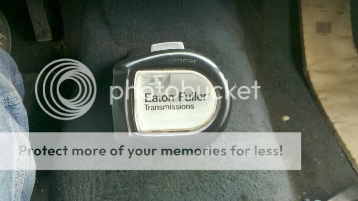

also changed the shifter today , the bushing was gone and i just happened to have a spare shifter in the garage , but it had the longer stub so i had to switch the bottoms , and here are 2 pics of the new shifter setup , it used to have one of them gay cheapo autozone light up style handles on it

first i got the starting issue solved , tured out to be a bad starter causing all my issues
here is the starter that came out

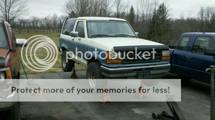

and today i got her up on jackstands and got the wheels off so i can put the 31's on these rims , and pulled the rear diff apart to get the carrier welded at school

and thanks to my big jack and jackstands i got plenty of height
