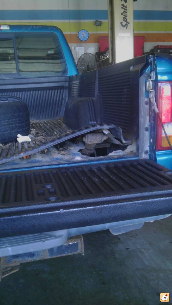

I fixed this at work to the tune of $750 and change.
Perch, shackle, and rear spring bushing on both sides.
As a bonus, I hammered his bed floor back down for free...
